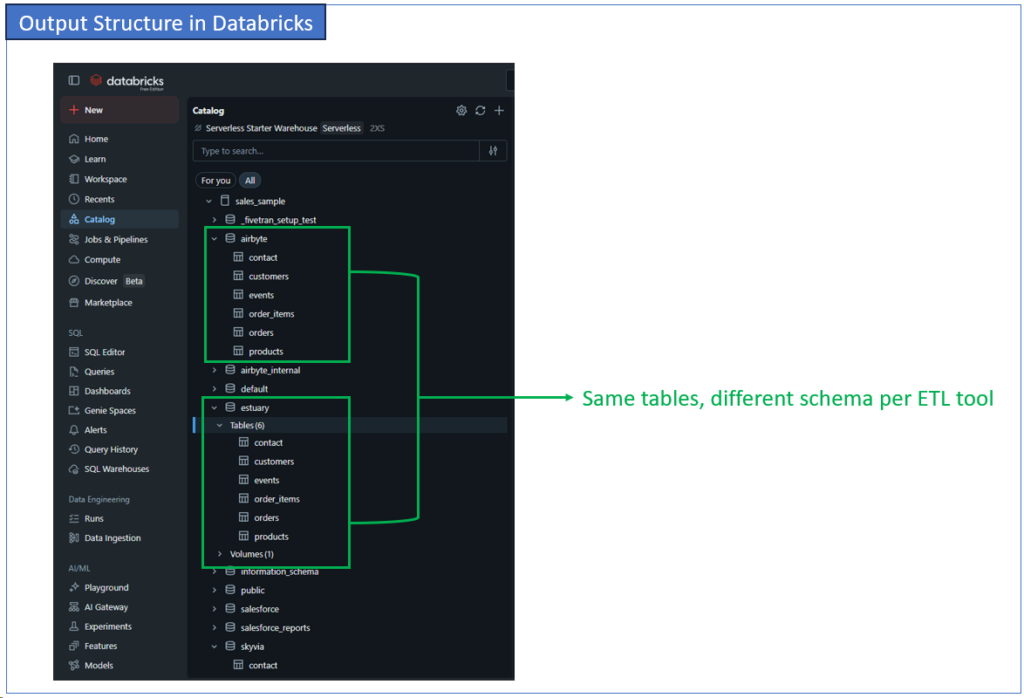

Also, I deliberately used a separate schema in Databricks for each tool, so I will see the differences in how they handled the data. Here’s a sample output structure for 2 of the tools I used in Databricks:
Output structure in Databricks

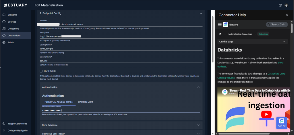

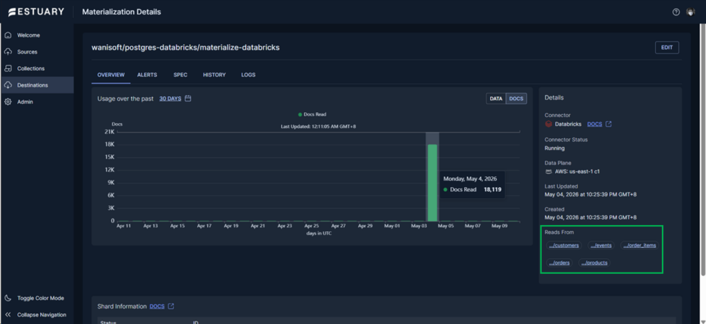

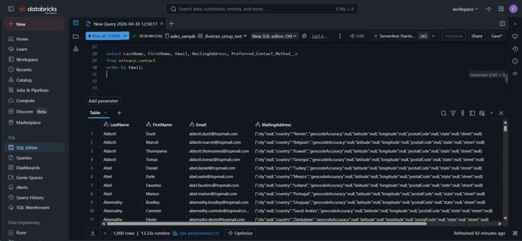

From the structure alone, you will see that Estuary and Airbyte had differences. Estuary used a volume to stage the data before finalizing it into the tables.

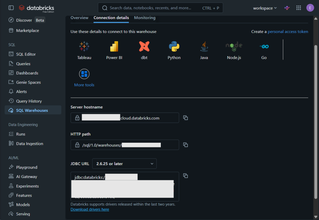

Databricks Connection Requirements
Let’s start with Databricks. Each ETL tool may ask for a hostname, an HTTP path, and/or access tokens. For Databricks CE, you can find the hostname and path in SQL Warehouses -> <your warehouse server>. Here’s mine:

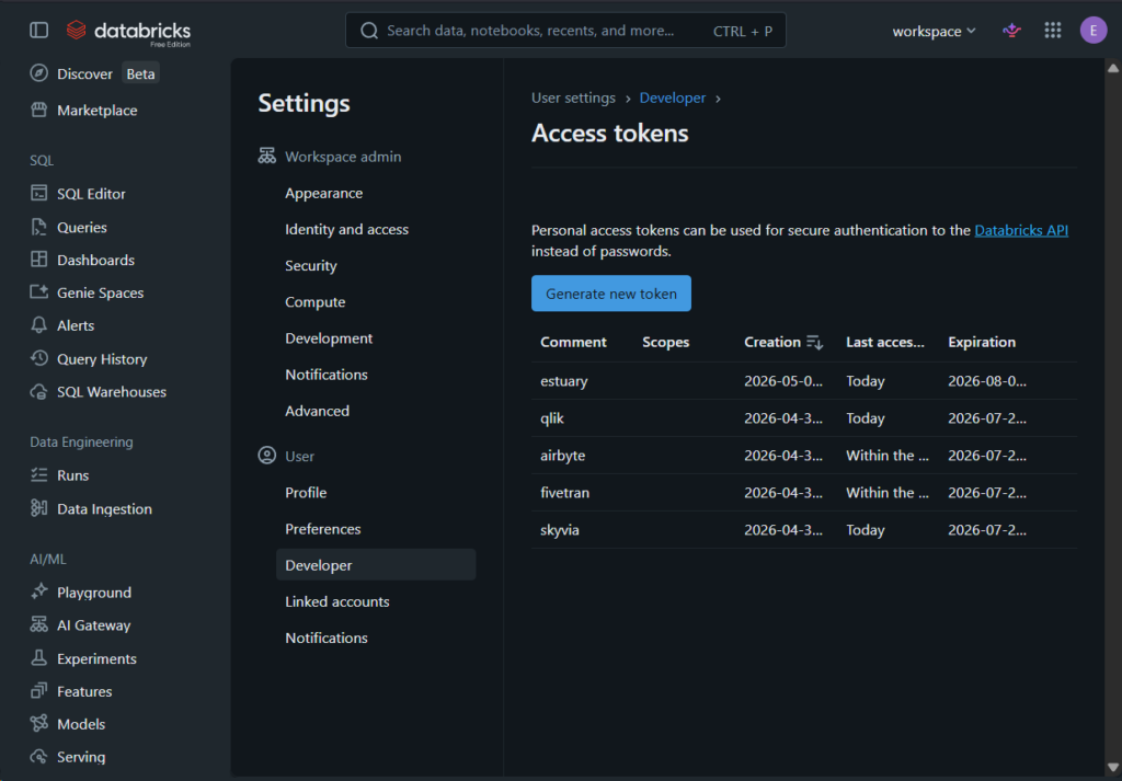

And the Access Tokens are found in my Settings -> Developer. I made access tokens for each tool I used here. See it below:
Databricks Access Tokens
There’s another way of connecting the tools using Client ID and Secret. But I used a Personal Access Token for the samples.

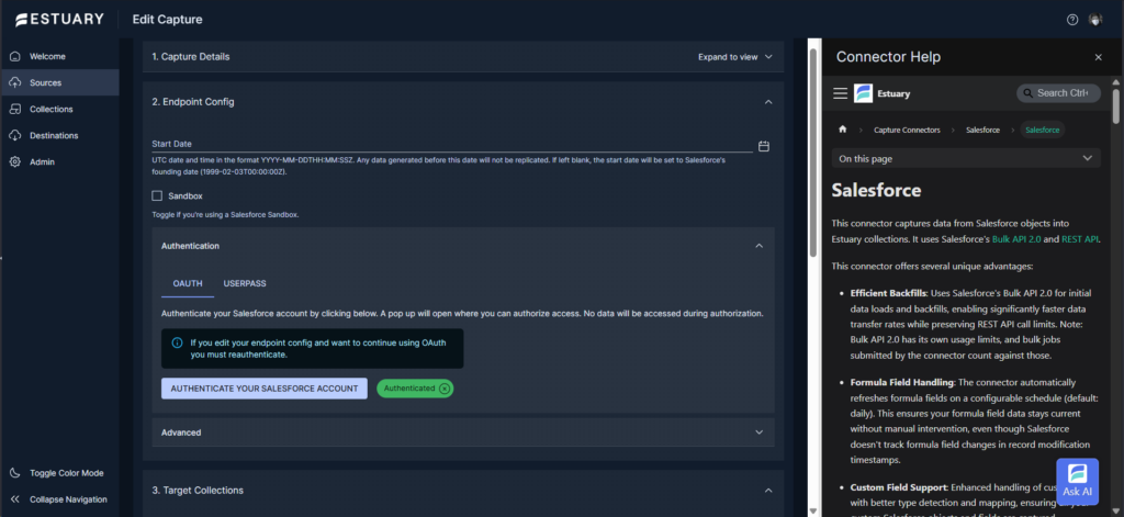

Except for Fivetran, each tool will ask you to log in to Salesforce to get an OAuth token, and that’s it. If you change your password, make sure to re-authenticate each tool.

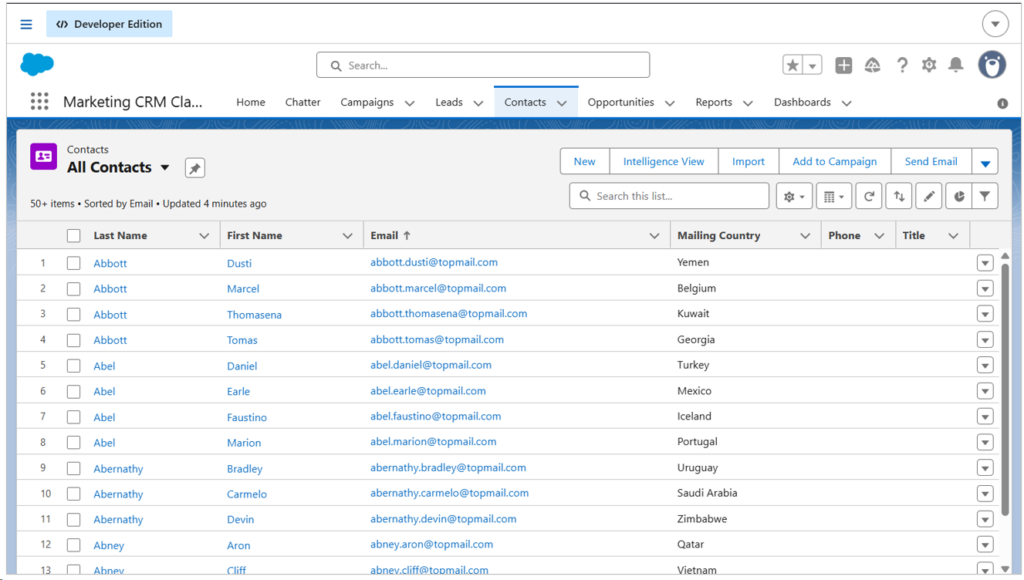

Here are some of the fictitious Contact data in my Salesforce developer account:
Salesforce Developer edition Contacts

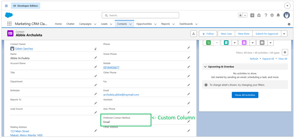

We will also see if custom columns can be captured. I added the Preferred_Contact_Method_c custom column in the Salesforce Contact object. See below:

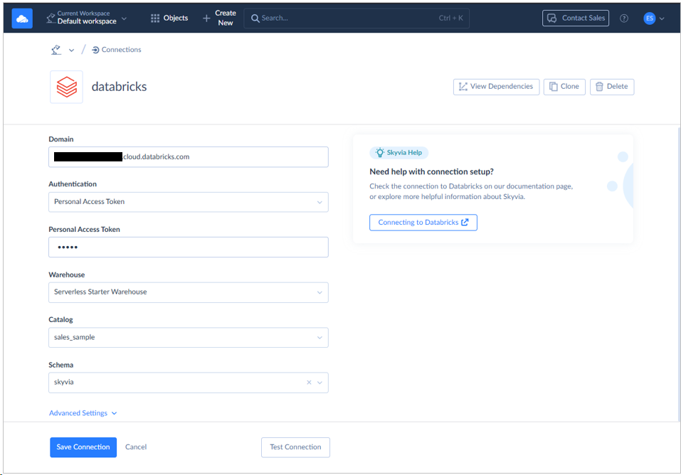

Setting up connections means filling out forms for credentials in Skyvia. I’m only reusing my PostgreSQL connection I made in this article, and the Salesforce Skyvia Connections that I made for my other article. But let me show you my setup for Databricks.
The domain should be the hostname. This got me confused at first, but it went well. The Personal Access token given by Databricks should go in the corresponding box.
Skyvia Databricks connection

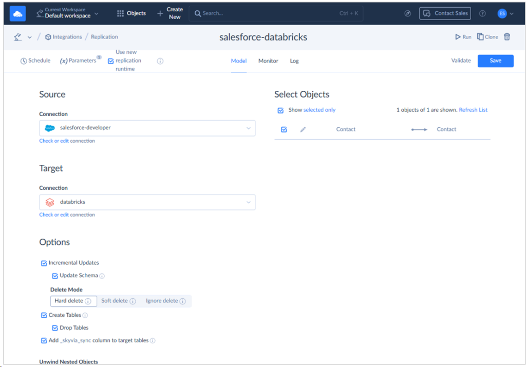

And below is my data pipeline for Salesforce to Databricks replication of the Contact object.
Salesforce Databricks integration by Skyvia

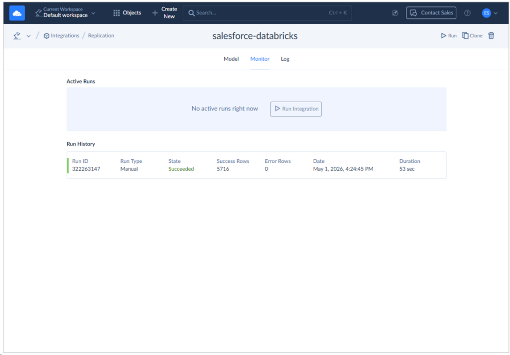

Running it took 53 seconds for more than 5,000 rows. Skyvia created the table for the first time in Databricks. Here’s a screenshot:
Salesforce Databricks integration by Skyvia monitoring

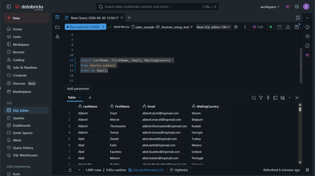

After the run, here’s the query result from Databricks’ end:
Databricks data integration results
You can compare it to the Salesforce screenshot earlier and see that it’s the same.

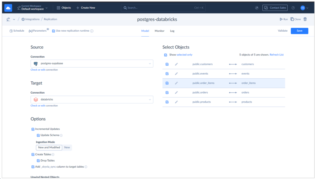

We’re going to use the same Databricks connection in Skyvia. Let me show you the setup for the PostgreSQL to Databricks replication:
Setting Up the PostgreSQL to Databricks Data Pipeline

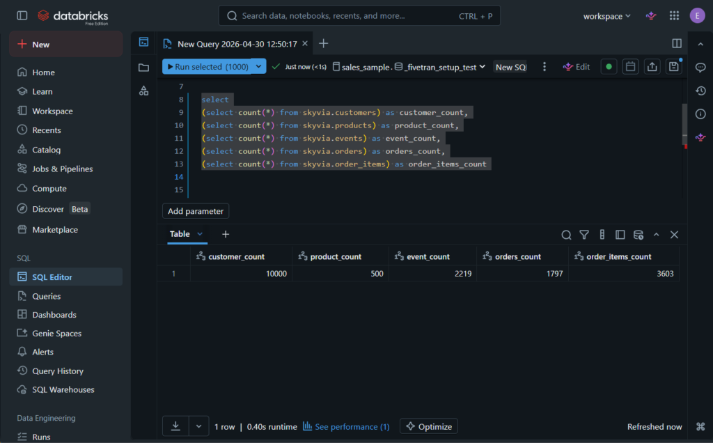

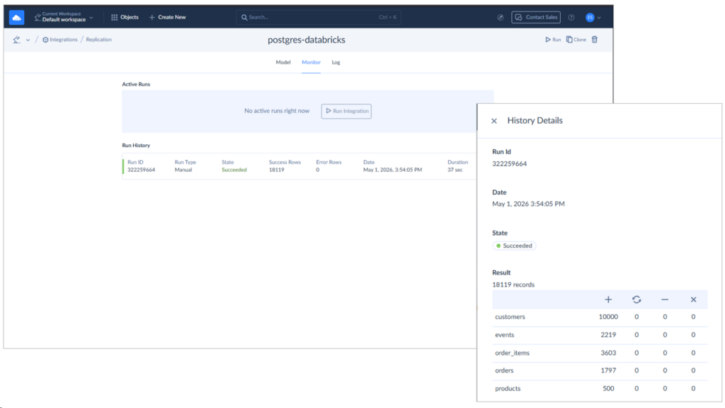

All the 5 tables are there, and it took 37 seconds to replicate more than 18,000 rows. Check it out below:
PostgreSQL to Databricks Data Pipeline results

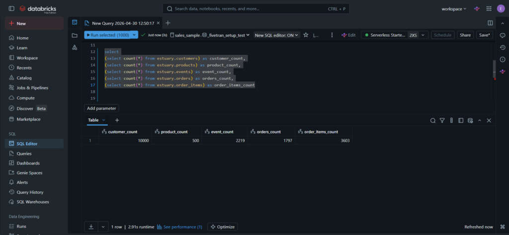

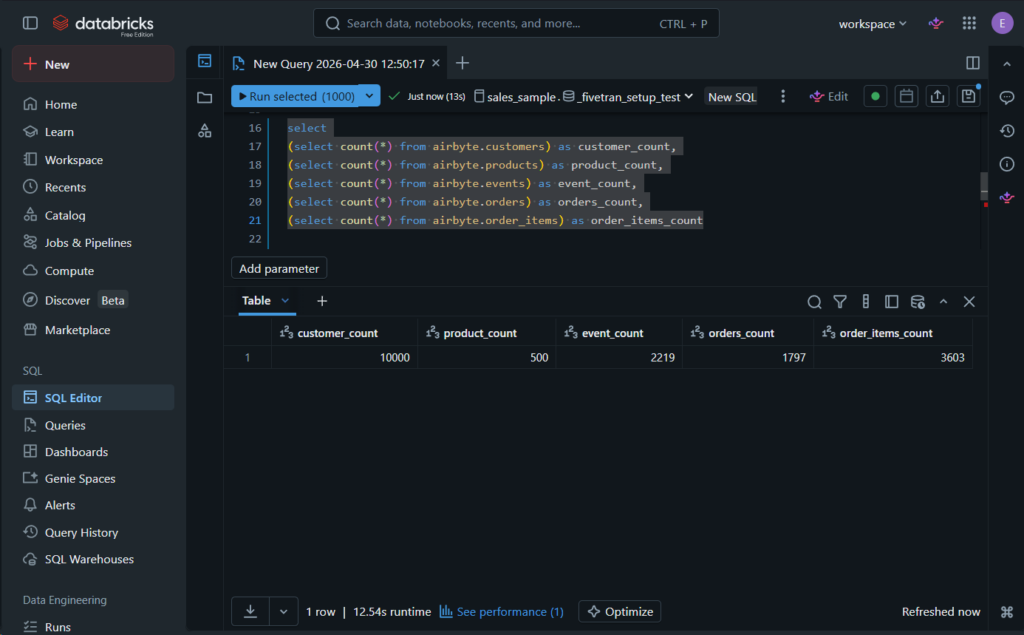

I compared the row counts above from Databricks end:
Databricks data results

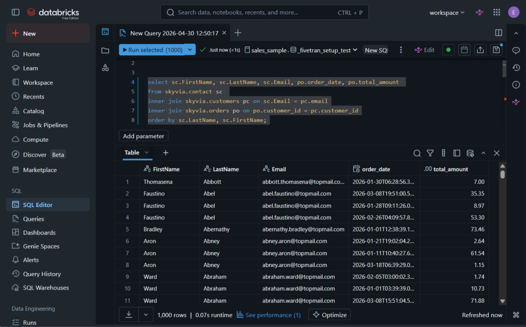

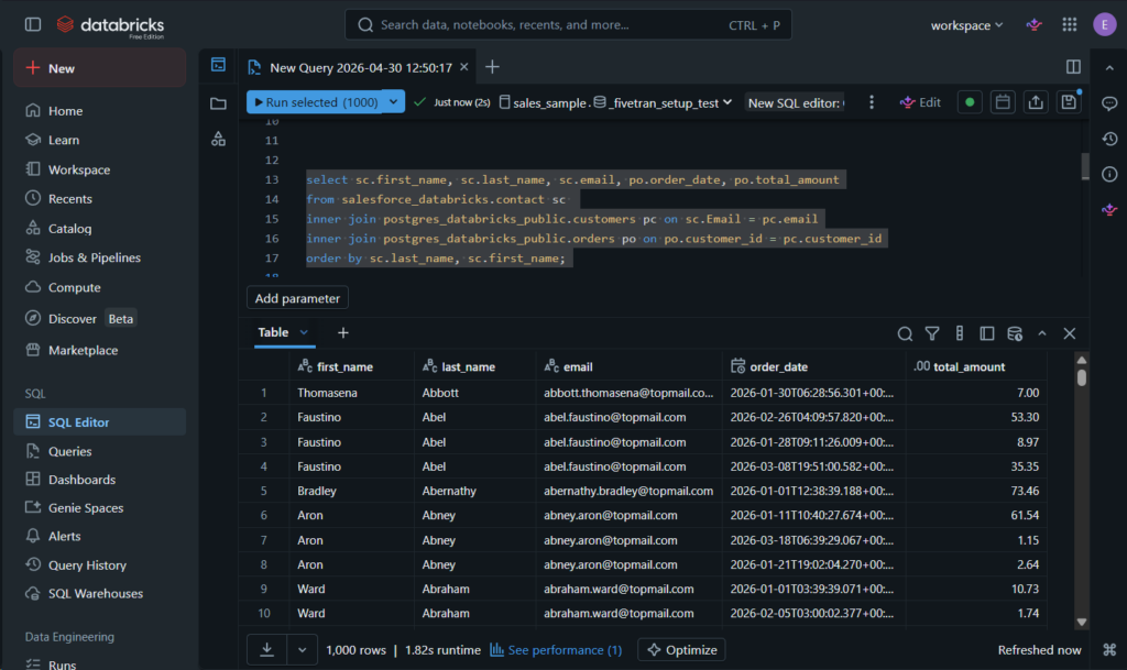

Check out also some of the replicated Salesforce Contact joined with the PostgreSQL transaction tables below:

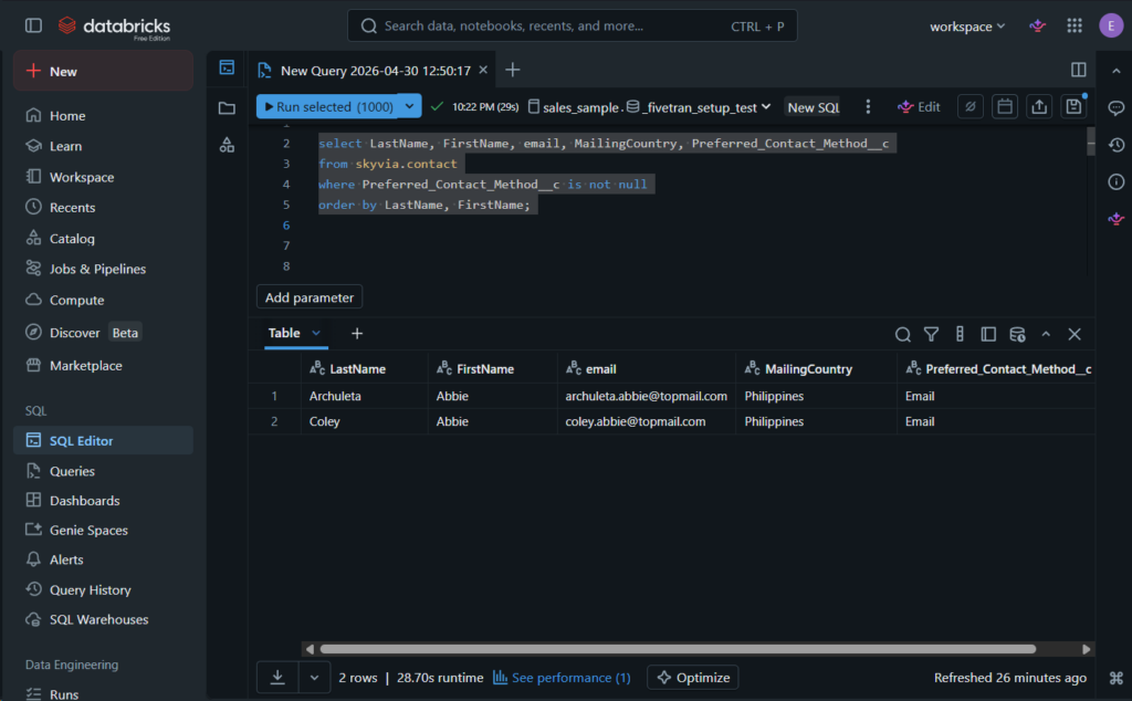

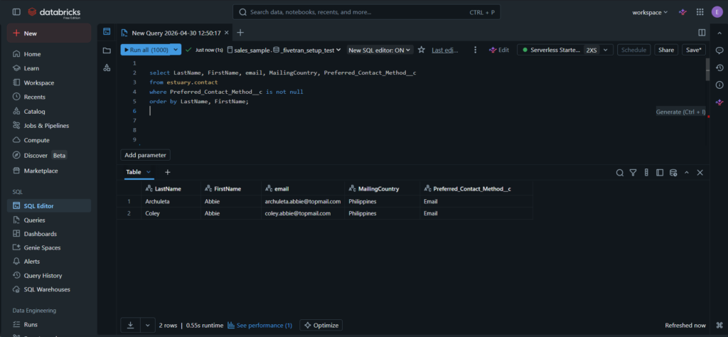

Lastly, I checked the data from our custom column, and it’s all good. See below:

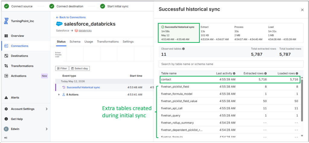

Fivetran creates an additional pipeline (fivetran_metadata) as well as some additional tables for sources like Salesforce.

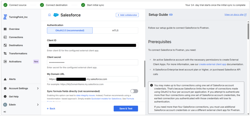

In order to set up Salesforce as the source, I had to create a connected app and get Client ID/Secret as well as Salesforce Domain URL. This is unlike the other tools we used here. See my configuration below:
Setting Up the Salesforce to Databricks Data Pipeline in Fivetran
Check how to create these Client ID and Secret in Salesforce from my previous post.

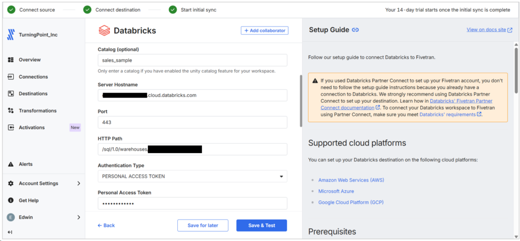

I also set up the Databricks destination for this pipeline. See it below:
Setting Up the Databricks Data Pipeline in Fivetran

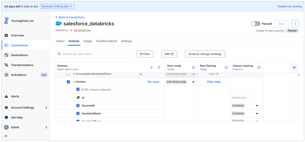

I notice that Fivetran does not include nested objects from Salesforce. When configuring Salesforce to Databricks pipeline, note also that the first sync report will include some additional tables. See below:
Fivetran historical sync
It took 1 minute and 58 seconds to sync the Contact table.

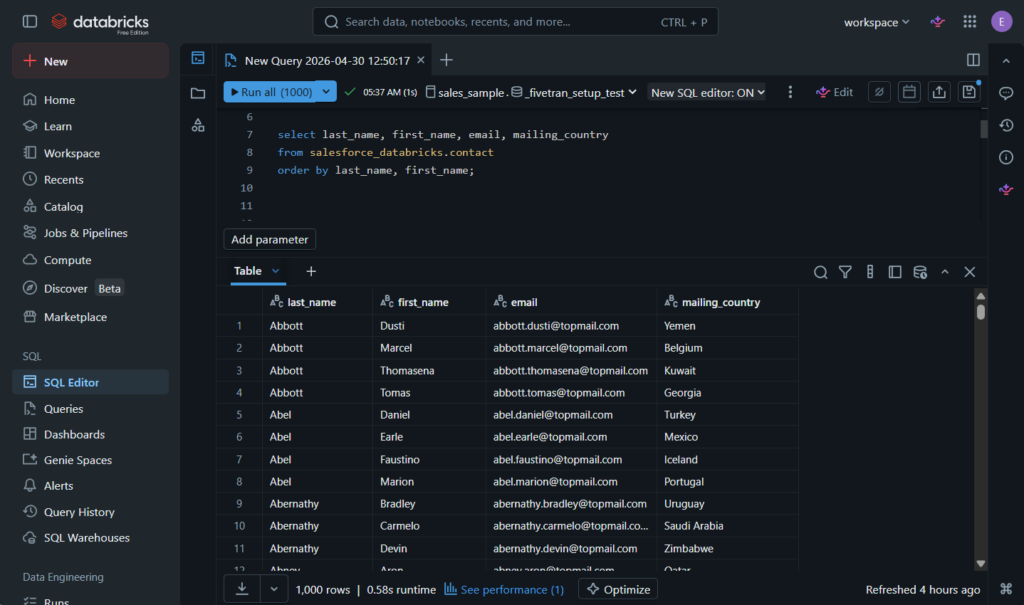

Anyway, Salesforce Contact row counts matched the other tools’ reports:
Databricks data rows

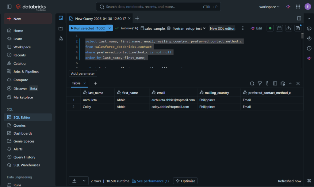

It also successfully replicated the data from the custom column:

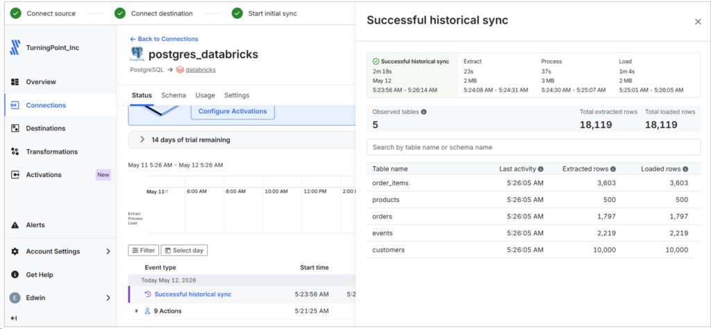

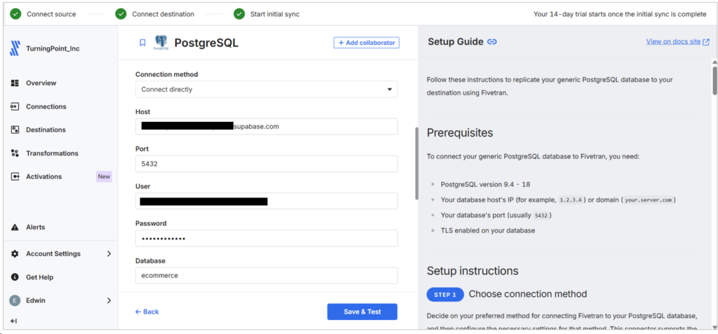

I made another Fivetran Connection, and this time for PostgreSQL. I used my Supabase credentials and specified the 5 transactional tables that had to be imported to the Databricks destination.
Below is my PostgreSQL connection:
Fivetran PostgreSQL connection
I just reused the previous Databricks Destination. After running the first sync, no extra tables were created in the process, and row counts were calculated per table:

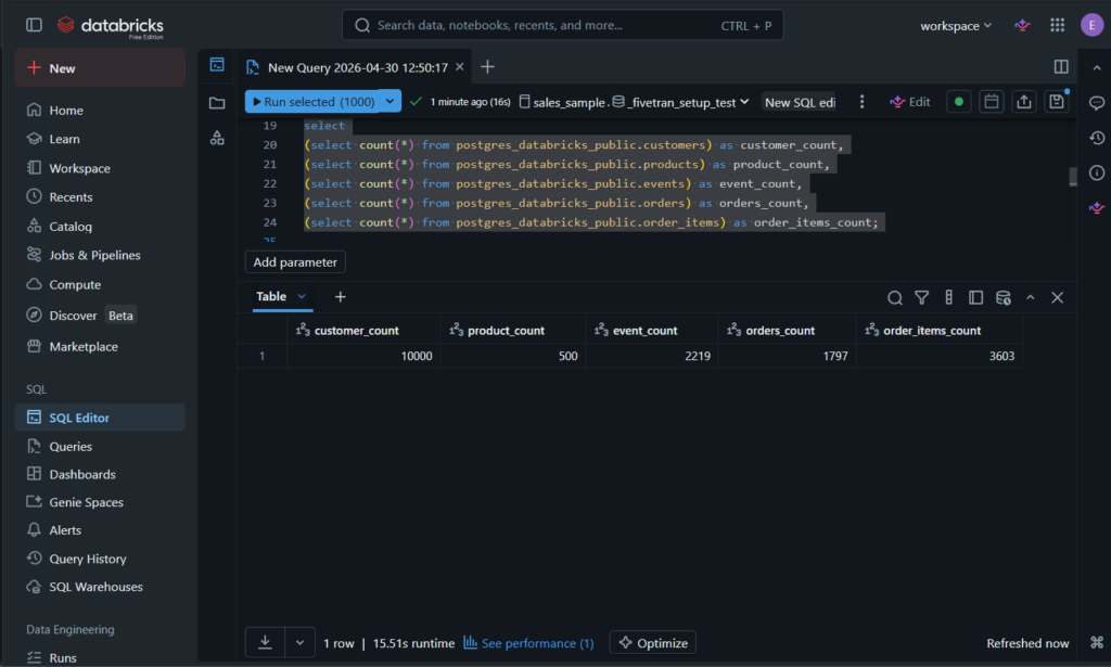

It took 2 minutes and 18 seconds to sync this one.
Please check the row counts below on the Databricks side:

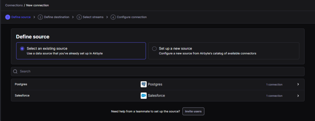

Airbyte’s Source and Destination setups are reusable, so I will only reuse the PostgreSQL and Salesforce connections I made from my previous articles.
I will go straight to setting up the pipeline and reusing Salesforce. The wizard starts by choosing an existing connection, like this one:
Airbyte new connection
I will choose Salesforce in this case. Then, the wizard will ask for a destination.

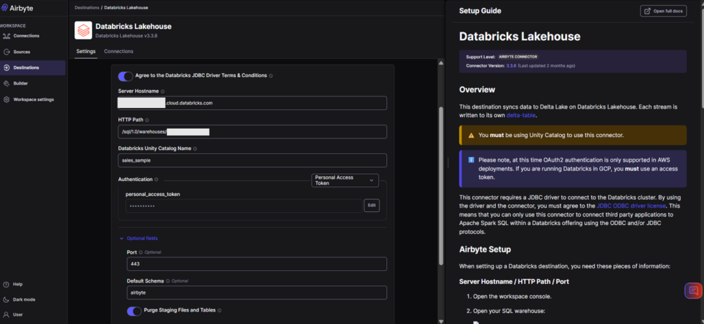

My Databricks destination was specified with the same credentials I have used across various tools. Check out my Databricks destination below:
Airbyte Databricks connection

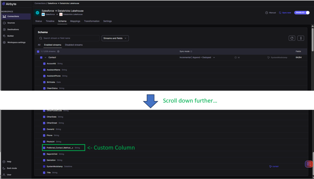

Then, I choose from the Salesforce objects (called streams in Airbyte). I choose Contact, and the custom column is available. See below:
Airbyte Salesforce Databricks connection custom column

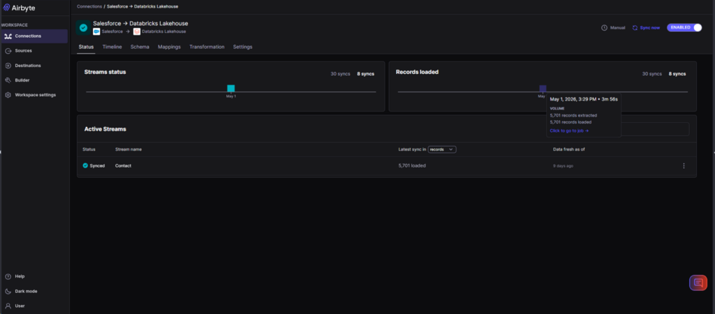

Running the sync to Databricks took 3 mins and 56 secs. See below:

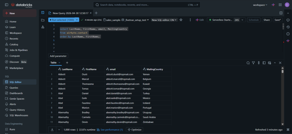

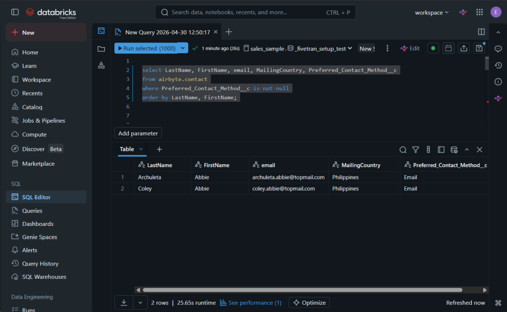

Finally, I ran a SELECT statement using the Airbyte schema in Databricks to verify the copy:
The result is an exact copy. There are 2 rows where I put values for the custom column, and it was captured in Databricks. See below:

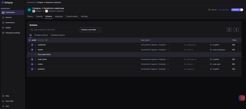

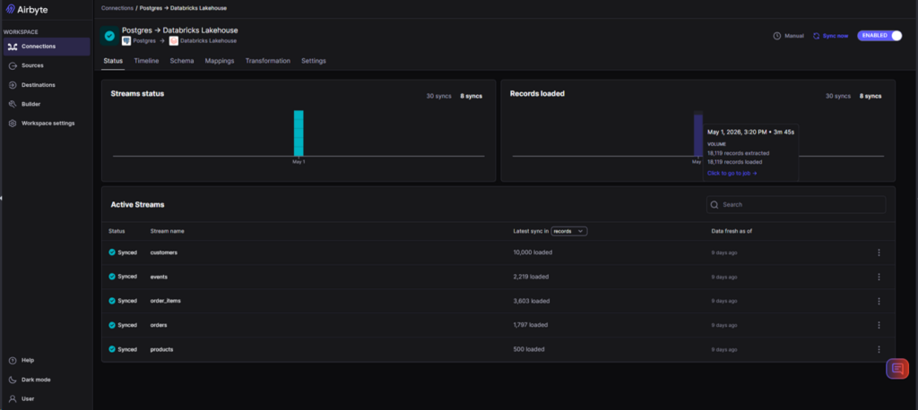

I also reused the PostgreSQL connection to Supabase, then chose the tables for replication:
Setting Up the PostgreSQL to Databricks Data Pipeline by Airbyte
Then, I also reused the Databricks pipeline I made earlier. The result of the first sync displays on the pipeline status below:
Airbyte Postgres Databricks connection
It took only 3 minutes 45 seconds to sync.
The overall setup of the 2 pipelines is around 5 minutes.

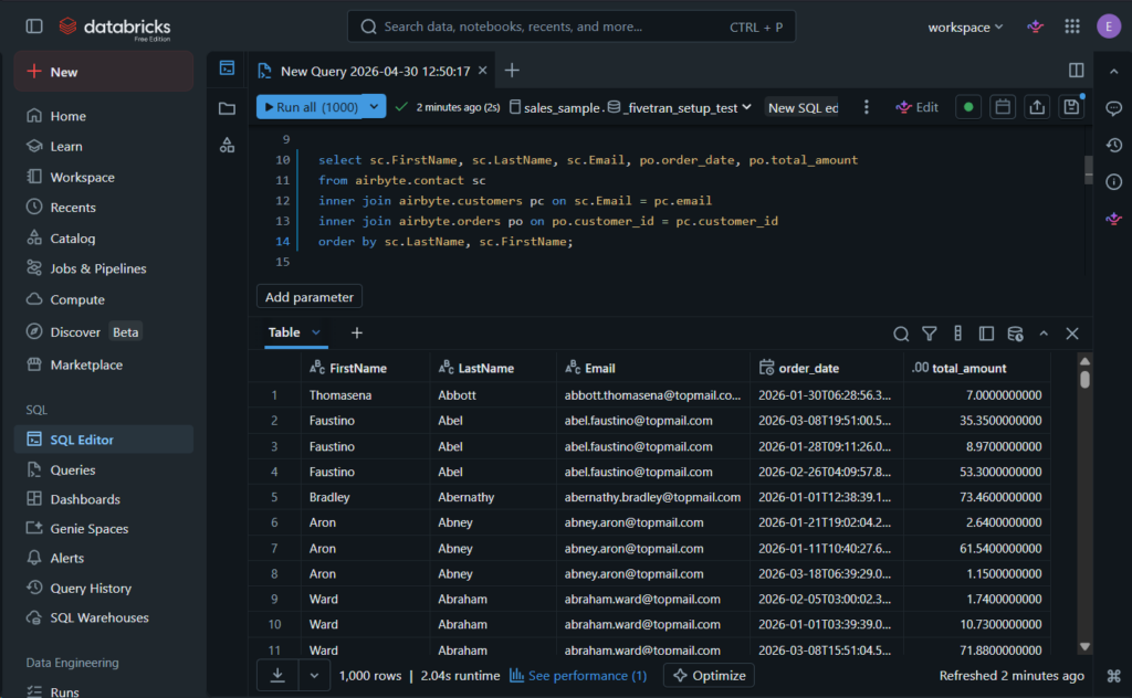

Finally, I ran a COUNT(*) to see whether my PostgreSQL tables are imported correctly in Databricks:
Databricks query data
The result is consistent with the source.I also made a query with joins against the data in the airbyte schema:
Again, it’s consistent with the other tools.
Apart from the graphical user interface, developers may use the official PyAirbyte library and Airbyte API to programmatically define sources, destinations, and connections. This makes Airbyte suitable for automated setup, reproducibility, or other customizations.
Airbyte Cloud is more suited to SMB and enterprise-level organizations that require an open-source solution that is either low-code or no-code.
Airbyte Core, however, would be preferable to businesses with professional development teams capable of configuring Airbyte on their preferred infrastructure.
Below are the reviews at the time of writing:
Airbyte Core is always free and open source.
Airbyte Cloud pricing plans include Standard, Plus, and Pro, using capacity-based pricing. You need to contact sales for a tailored quote. For mode details, visit the Airbyte pricing page.

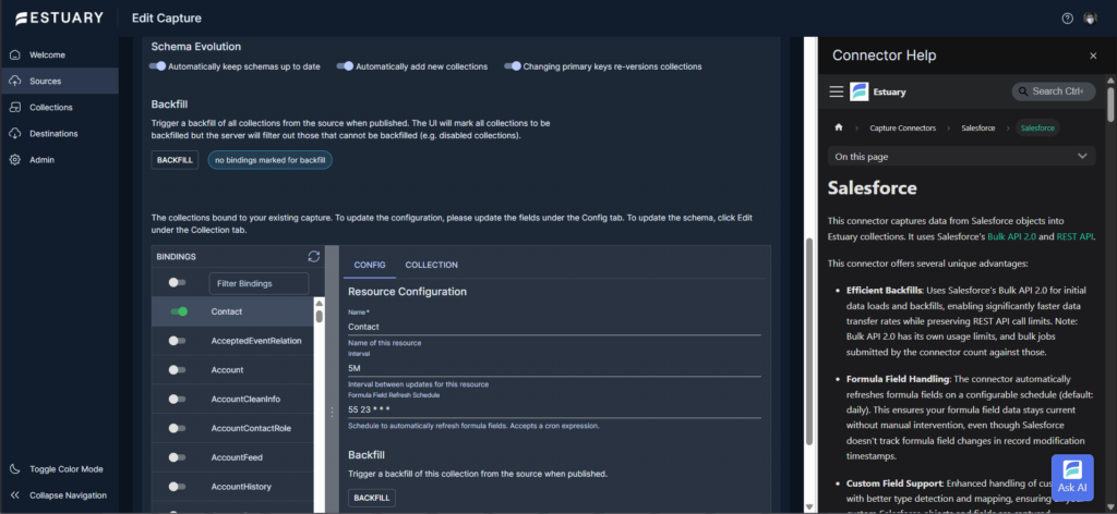

This one was easier – I just logged in to my Salesforce org, and it provided a security token for the new Estuary Capture. Below is the Endpoint Config:
Estuary Salesforce connection
The Authenticate Your Salesforce Account button will trigger the login to Salesforce. The above is marked Authenticated, meaning Estuary got my Salesforce security token. And below are the bindings for this capture:
Estuary schema evolution
Since you have to create bindings to include the tables needed for the capture, you can’t reuse this capture unless there’s another requirement with the exact capture needed.

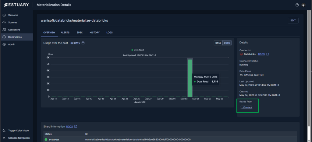

Then, I made a Materialization (or destination) to Databricks and chose a frequency between 0 seconds and 4 hours. Defaults to 30 minutes if you don’t supply a frequency. Below is the result of the first sync:
Estuary Databricks Materalization details
The 5,716 rows are consistent with the source. Sample below. Also, nested fields were serialized to JSON objects similar to Airbyte.
And below are the rows captured for the custom column:
custom column rows in Databricks

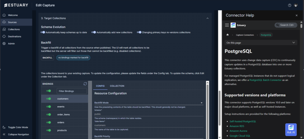

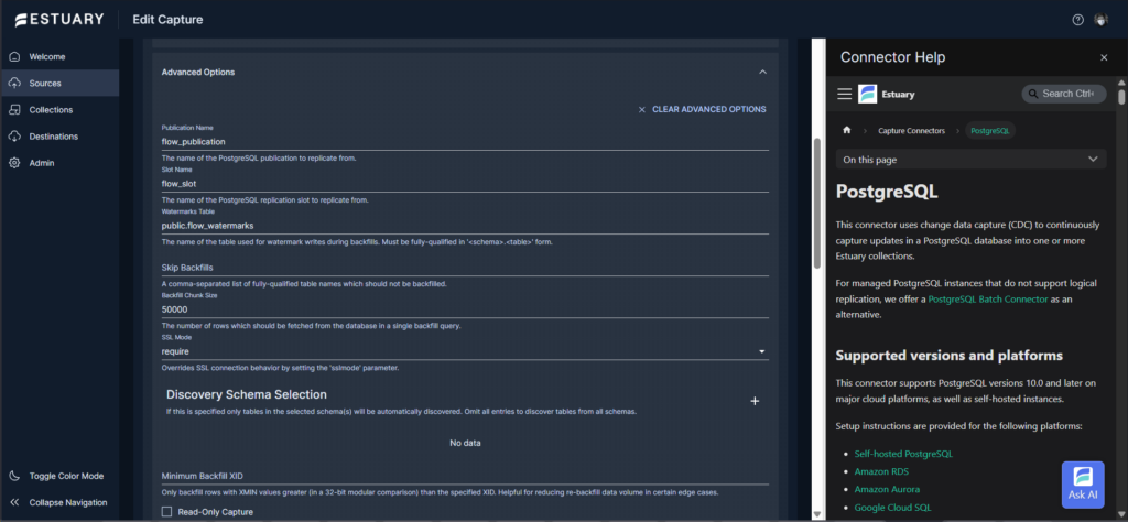

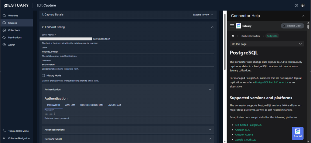

For my purposes, I had to create a New Capture using the PostgreSQL connector. However, this capture required a database with wal_level=logical, and supports PostgreSQL publications, something that Supabase does not allow. Thus, I found and used Neon, where I replicated my Supabase DB using dbForge Studio for PostgreSQL and activated the necessary options.
Check out the PostgreSQL Capture Endpoint Config below:
PostgreSQL connector by Estuary
Below is the Advanced config required by Estuary for this database:
Estuary automatically created the flow_watermarks table in my PostgreSQL database.
Below are my bindings for this capture. It includes the 5 tables we’re using for the test.
Then I went to create a new materialization (or destination), where I had to point it again to Databricks. Then, link it to the above PostgreSQL capture.
Below is my Databricks Endpoint config:
Estuary Databricks Materialization details

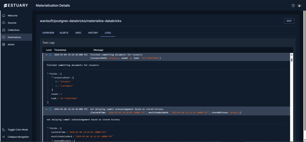

Below is the result of the first sync. Note that the number of rows processed are summed no matter how many tables you capture.
Estuary Materialization details
You have to dig into the long list of logs to see how long it took to run the sync and how many rows per table. Below is what I think is the duration for the customers table sync at around 24.8 sec.:

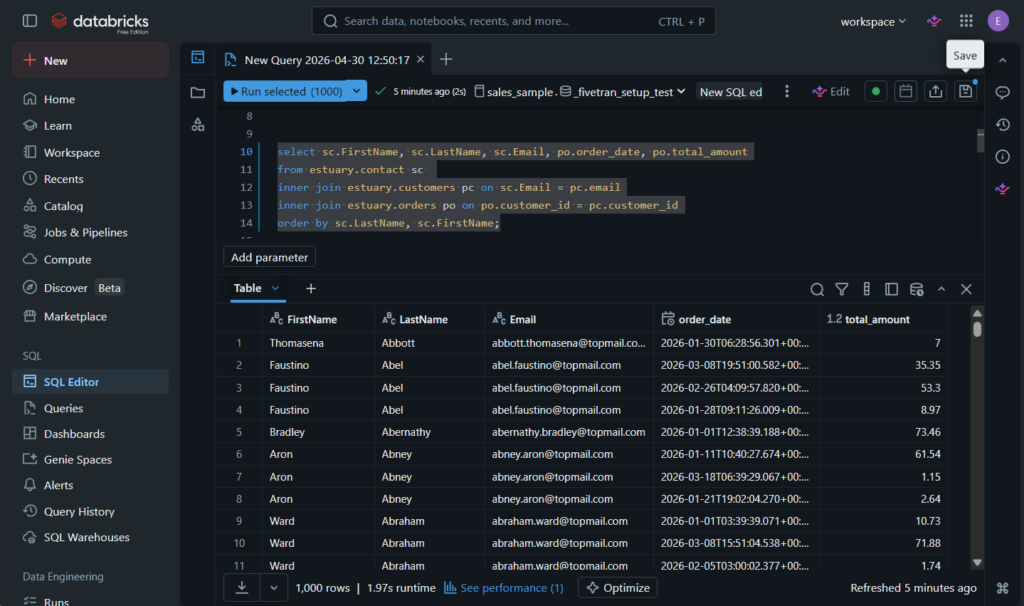

Once materialized, the tables appeared under the estuary schema in Databricks. By querying the tables, I saw that everything was working well. See the row counts below:
Joining both the Salesforce and PostgreSQL tables results in the following:
This is also consistent with the other tools.

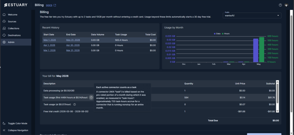

Reviewers have good ratings for Estuary:
Estuary offers a free developer account with limits (10GB/month and 2 concurrent connectors). For production systems, there’s a 30-day free trial then you start paying for $0.50/GB + $100/connector.
In their billing page, connectors are indicated as tasks in hours. Here’s the computation for the data pipeline I made with 3 connectors. The trial credits are deducted:
Estuary billing page
For more details, visit the Estuary pricing page.
