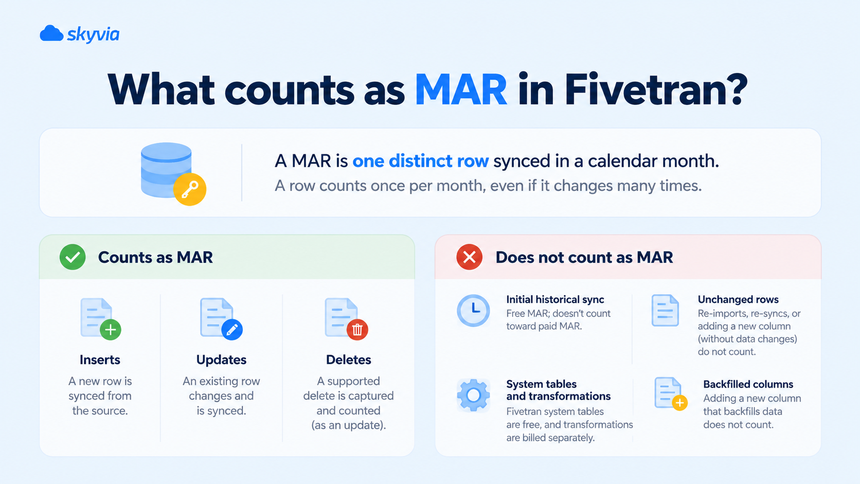

What counts as a monthly active row
A monthly active row is a distinct primary key that was inserted, updated, or deleted and synced during a calendar month. A row counts once a month, however many times it changes. Fivetran’s own example: a key synced 30 times in a month is one MAR.
Keys are counted separately for each connection and each table. The counter resets on the first of the month, so a row that changes in October and again in November is billed in both months.
Some rows are free. The initial sync of a new connection, the first load of a new table, and unchanged rows in a scheduled re-sync don’t count. Every new account gets a 14-day free trial, and after that, every new connection gets 14 days of free use once incremental syncs start.

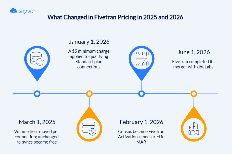

Even deleting data comes with a price tag in this economy. Fivetran started billing pay-as-you-go accounts for deleted source rows on January 1, 2026. Inserts and updates are already counted, and deletions now join them. Annual contracts signed after March 1, 2025 follow the same rule once renewed.
Each connection is priced on its own curve
Since March 2025, volume discount doesn’t cover a whole account; it stops at each connection. No pooling MAR for a better deal. That’s the rule in Fivetran’s Service Consumption Table, and it also rules out counting activations or other accounts toward the same discount.

Since February 1, 2026, Fivetran sells Census as Fivetran Activations, on the same contract and invoice. An activation is every sync from one source to one destination, such as Snowflake to one Salesforce org, and each activation gets its own MAR curve.

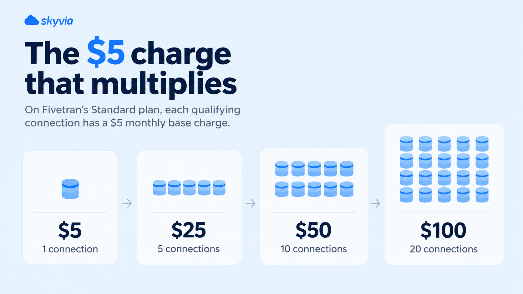

The $5 base charge on small connections
That $5 charge isn’t quite the safety net the word “minimum” suggests. On paid plans, every connection with 1 to 1 million monthly MAR pays it on top of the per-row cost. Fivetran also calls it a base charge, which better explains why 2,000 MAR produces a $5.99 bill rather than $5.
It adds up on wide, thin stacks. Twenty connections at 2,000 MAR each cost $119.79 a month, while the per-row part alone is $19.79. Connections with zero paid MAR and accounts on the Free plan don’t pay it.

How Fivetran Pricing Changed in 2025 and 2026
So much happened with Fivetran pricing during the last two years that many older articles on this topic still describe plans that no longer exist. The changes, chronologically.
The first changes were introduced on March 1, 2025:
- Volume discounts are now for connections; accounts no longer have this privilege.
- Annual discounts became automatic; no need to negotiate them anymore.
- Fivetran said goodbye to the Starter and Private Deployment plans.
- Also, starting from this point, users can re-sync unchanged rows for free.
Next, on January 1, 2026:
- Pay-as-you-go accounts were the first to see Fivetran’s updated pricing.
- A $5 base charge now applies to connections with 1 to 1 million MAR, while deletions count toward paid usage.
- History mode also bills repeated updates to the same row.
- Annual customers see the base charge at renewal.
- For contracts signed after March 1, 2025, that’s also when the updated delete and history-mode rules take effect.
- Older contracts already had those charges.
The last change (so far) happened on February 1, 2026.
- Activations (formerly Census) joined the price list.
- The current Service Consumption Table (V.10) took effect.

What counts as a monthly active row in Fivetran?
One MAR is any distinct primary key that gets inserted, updated, or deleted, then synced, inside a single calendar month. It doesn’t matter if that row changes once or dozens of times: it’s counted a single time, and each connection and table keeps its own tally. On the first of the month, the count starts over.
Are initial syncs and deletes billed in Fivetran?
New connections get a free initial sync, followed by 14 free days of incremental syncing. Deletes aren’t so lucky. They’ve counted toward paid MAR since January 1, 2026, for pay-as-you-go accounts. Annual contracts signed after March 1, 2025 pick up that rule at renewal.
