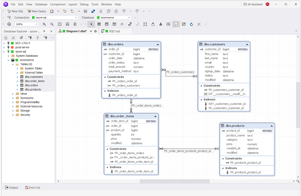

But first, I prepared sample data with the structure below:

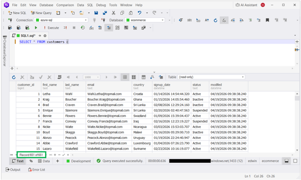

SQL Server Sample Dataset

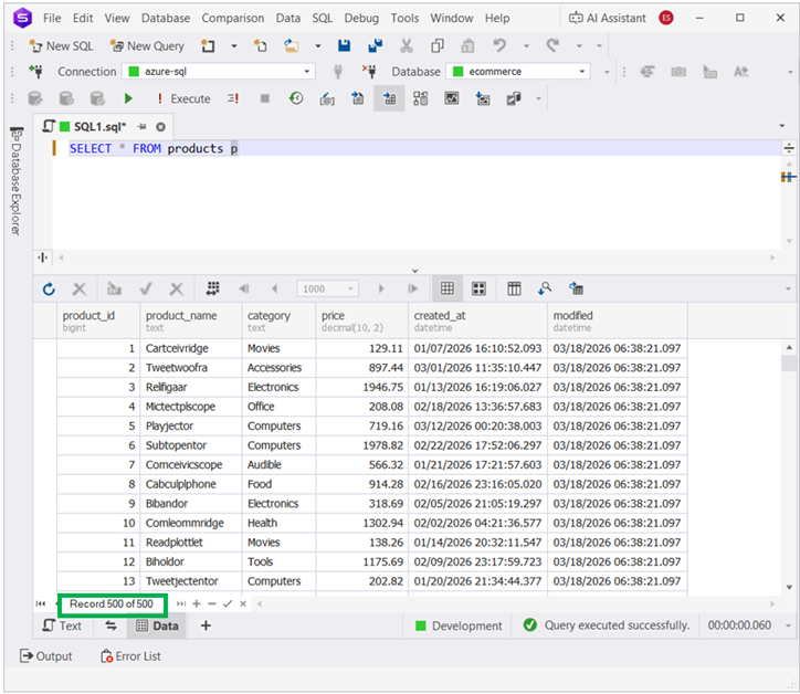

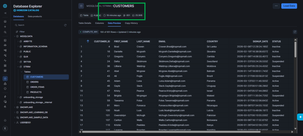

That’s a SQL Server database in Azure. It has 651 customers. These names are not from real people. You can preview some of them below:
I also have 500 products, and 13 of them can be seen below:

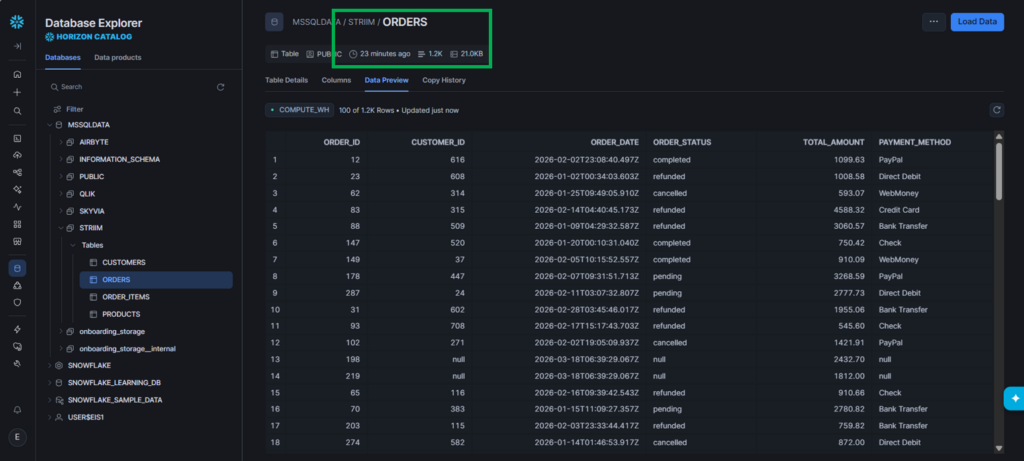

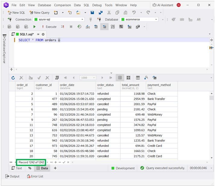

Most of the customers were used in 1242 orders. You can see a few of the orders below:

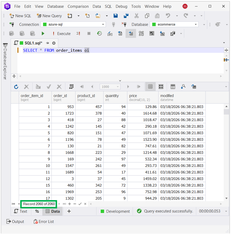

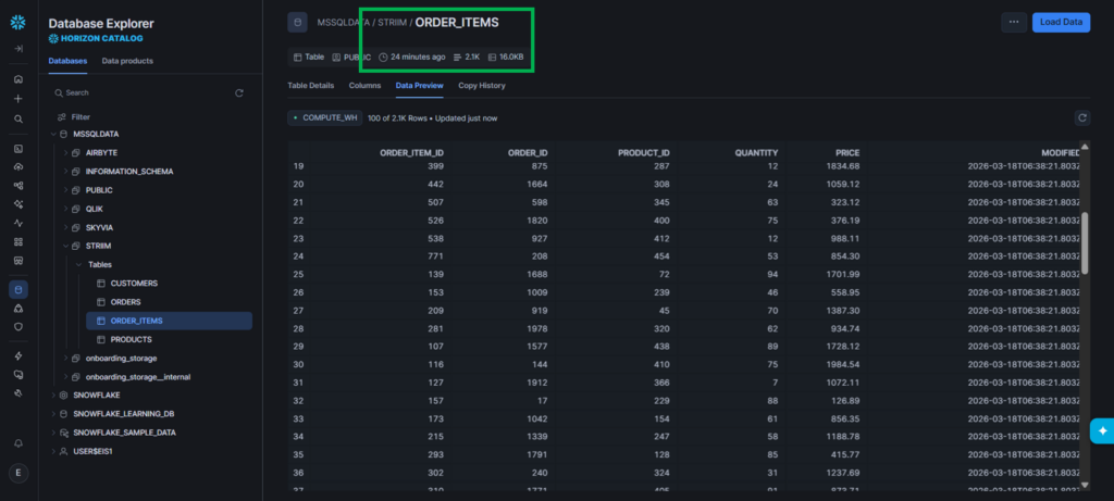

Finally, these orders have a combined 2060 order items with products from the table above.

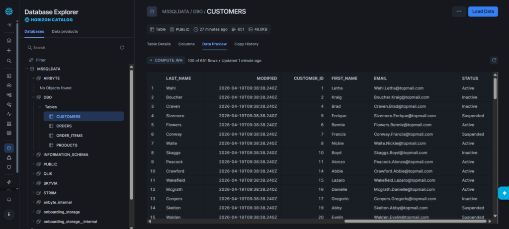

Snowflake Database Structure

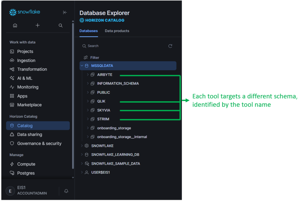

We organized the database in Snowflake so that each tool will migrate data into its respective schema. This also assures us that no tool will overwrite another’s copy of data. That way, you will also see how these tools will stage and write the final results in Snowflake.
See the schema organization below in Snowflake. These schemas are empty from the start. No tables, stages, or other Snowflake objects.

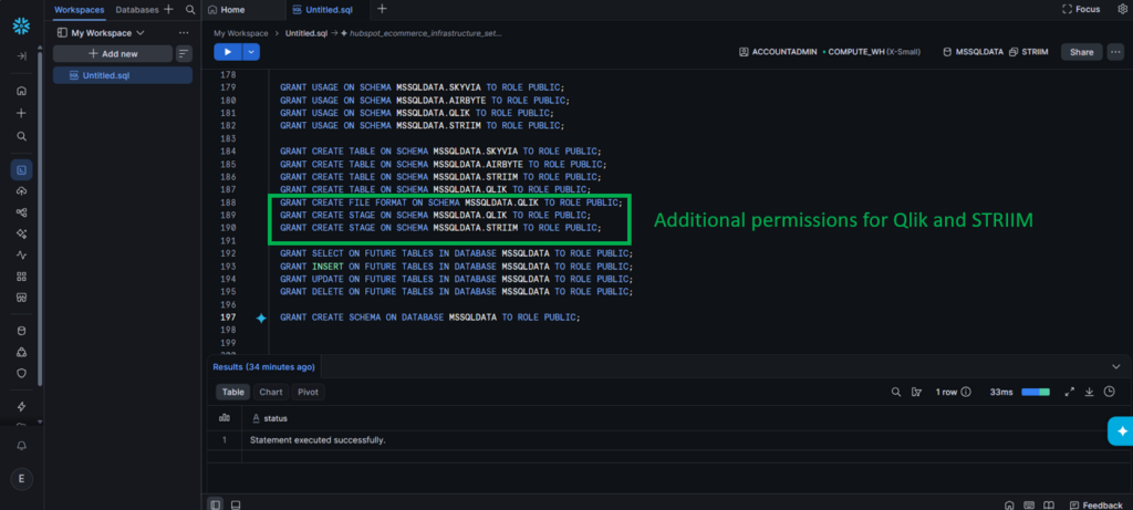

For this test, I still need to add permissions to a new Snowflake database with several schemas. I used the one below.
Qlik Replicate and Striim will have extra permissions, and you will see why later.

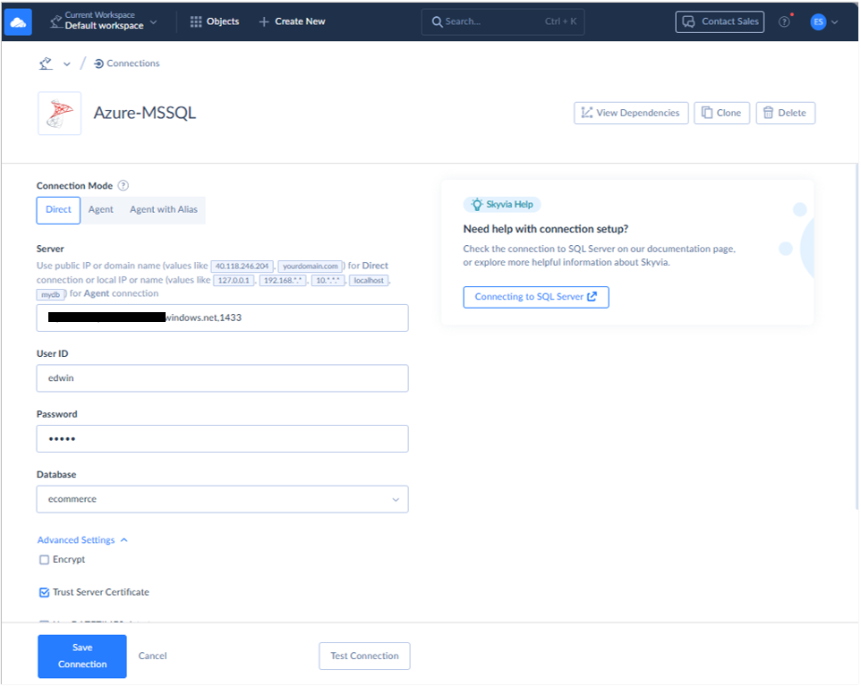

The SQL Server database I used is in Azure. I made a Skyvia connection for that with configurations illustrated below:
Azure connector by Skyvia
The important parts there are the Server (in Azure), the User ID, Password, and Database name.

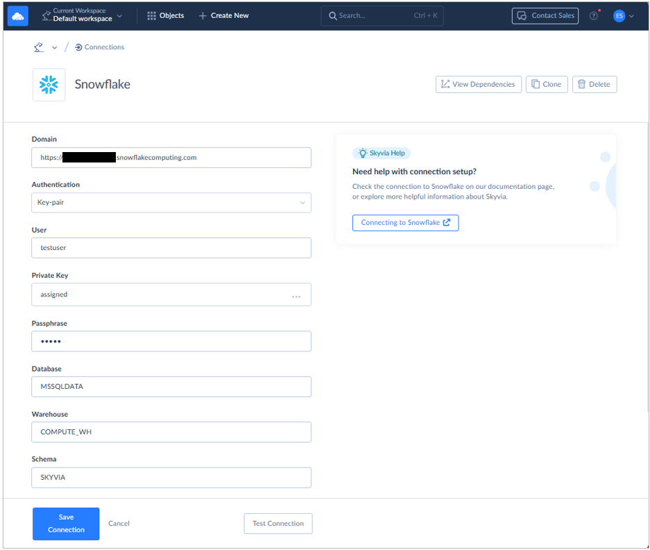

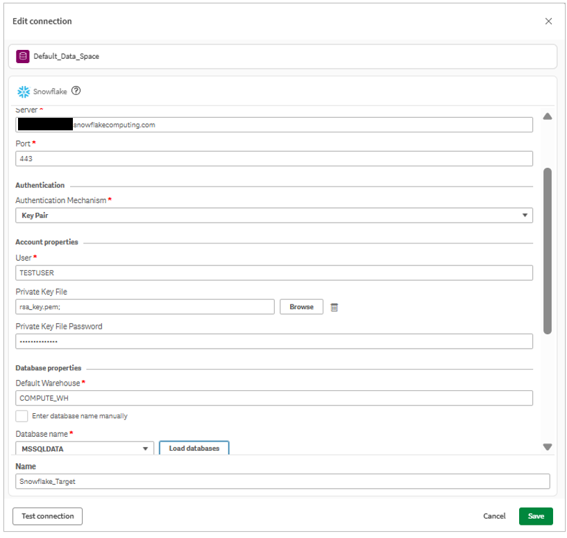

Then, I prepared the Snowflake connection with the following configuration:
Snowflake connector by Skyvia
It needs the Snowflake URL, username, Key Pair authentication, a Private Key file, Passphrase, Database, Warehouse, and Schema. Note the SKYVIA schema because we want the replication process to write there.

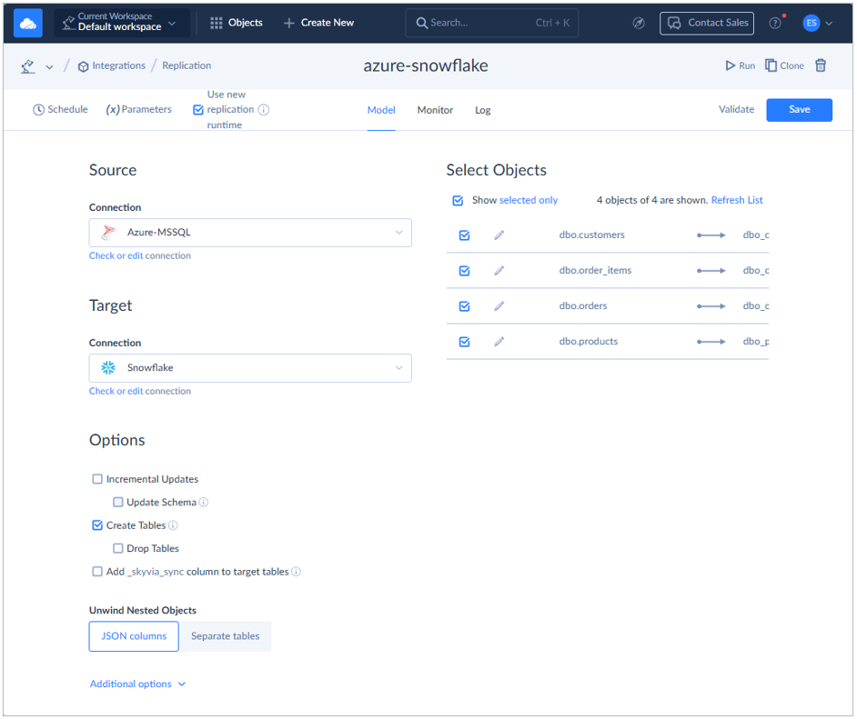

Finally, the Replication pipeline. I used the SQL Server and Snowflake connections I made above. Then, I selected the customers, products, orders, and order_items tables.
the Replication pipeline: the SQL Server and Snowflake connections
Because I’m used to setting this up, it only took me 5 minutes. Newbies can do this in 15 minutes. This is why Skyvia is for getting pipelines moving in a short time.

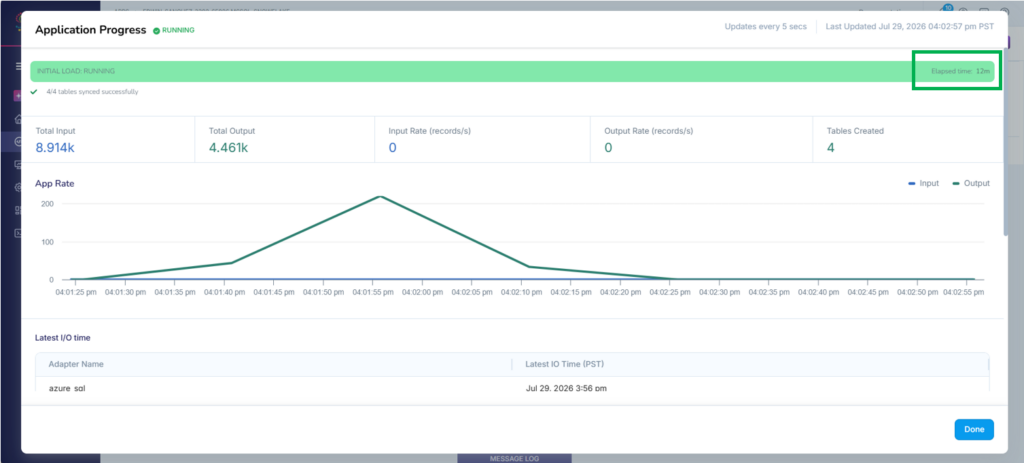

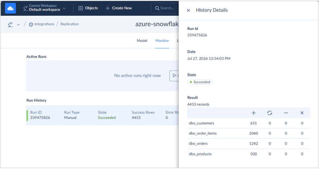

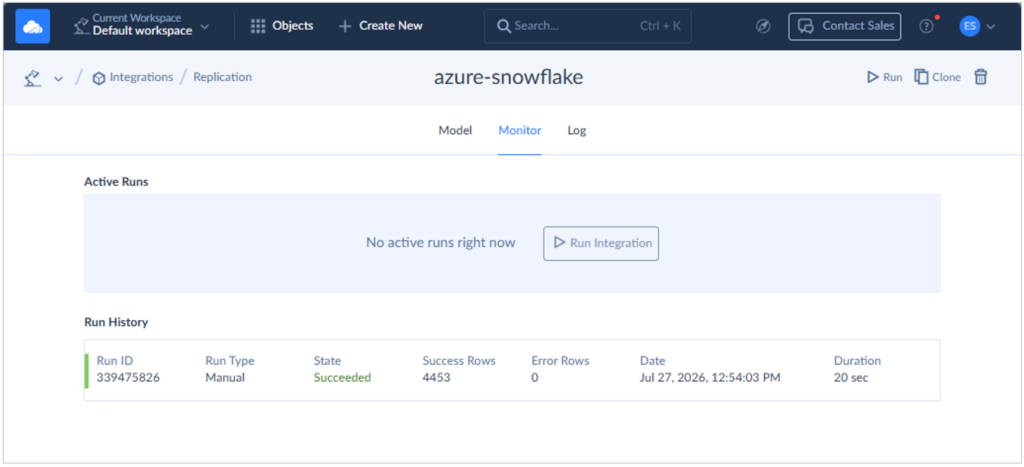

The Runtime Results
Note the runtime results below. It took the process 20 seconds to do the initial load to Snowflake.
runtime results for Azure Snowflake
Upon checking, the row numbers uploaded to Snowflake are the same as our test data earlier.
Skyvia prefixed the table names with the schema name used in SQL Server.

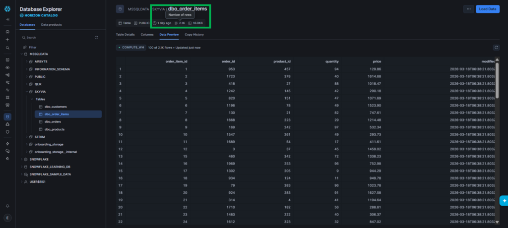

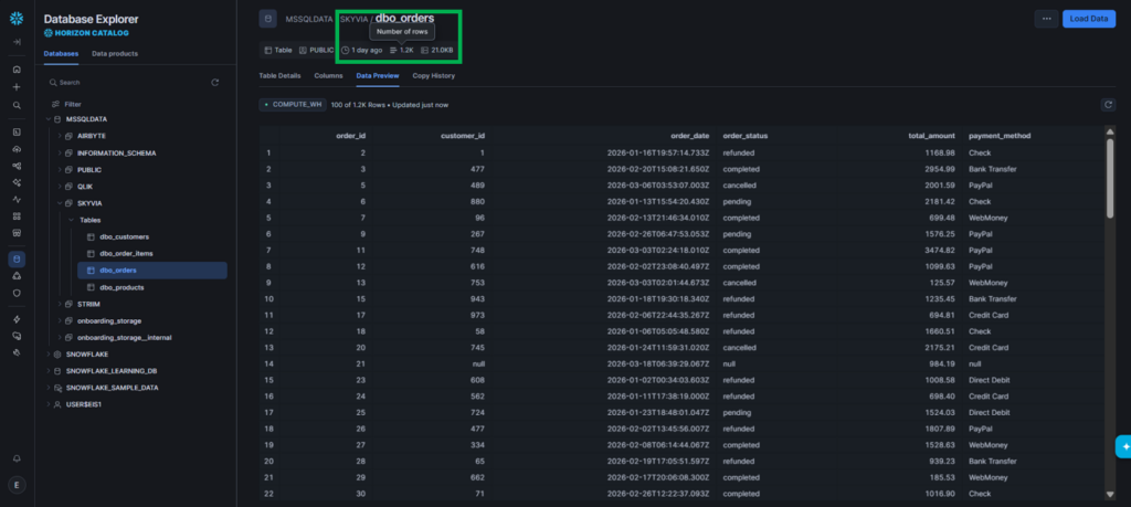

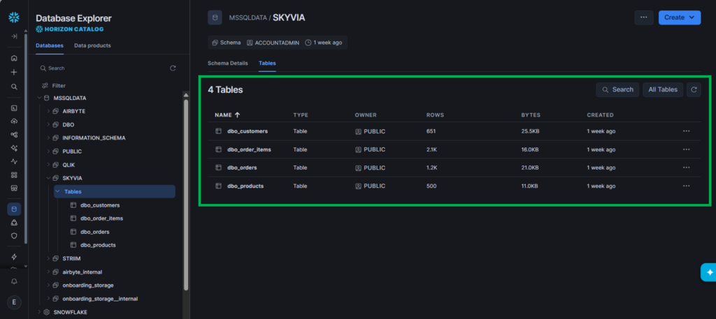

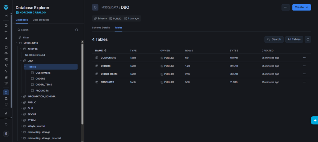

Validating the Results in Snowflake
The results we’ve seen in Skyvia are also in Snowflake. The 4 tables and their row counts are the same as the sample data earlier.
Skyvia's data in Snowflake: 4 tables and their row counts

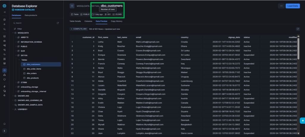

Here’s a preview of the uploaded customers. Boxed in green are the row counts, which is 651 customers.
Skyvia's data preview of the uploaded customers in the Snowflake

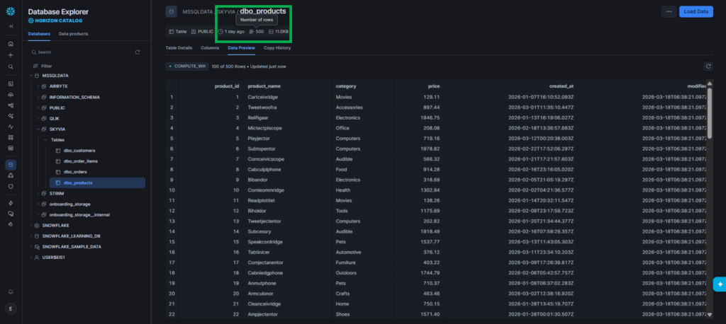

Then, below is for products:
Skyvia's data preview of the uploaded products in the Snowflake
And then, for orders:
Skyvia's data preview of the uploaded orders in the Snowflake
Finally, for order items:
Skyvia's data preview of the uploaded order items in the Snowflake
The data was replicated as is for 20 seconds and verified in Snowflake.

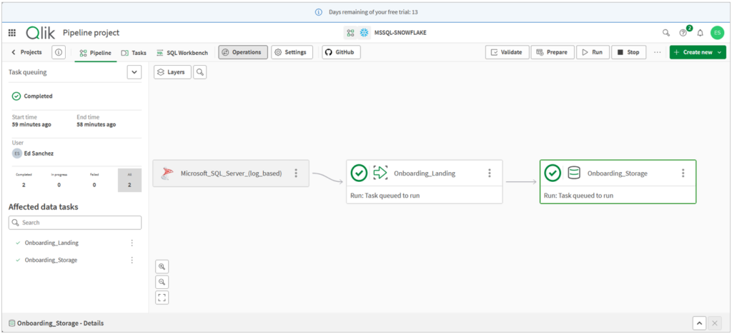

Preparing the SQL Server to Snowflake Pipeline Using Qlik Replicate

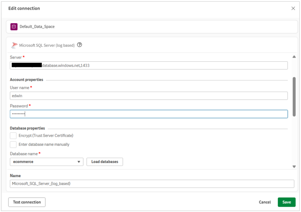

I used the same SQL Server and credentials in Qlik Replicate to configure the SQL Server connection. See it below:
Microsoft SQL Server by Qlik Replication
I also used the same configuration in Snowflake. Check it out below:
Snowflake by Qlik Replication
For Qlik, the pipeline will write the tables under the QLIK schema in Snowflake. Below is the pipeline design from SQL Server to Snowflake:
the pipeline design from SQL Server to Snowflake by Qlik

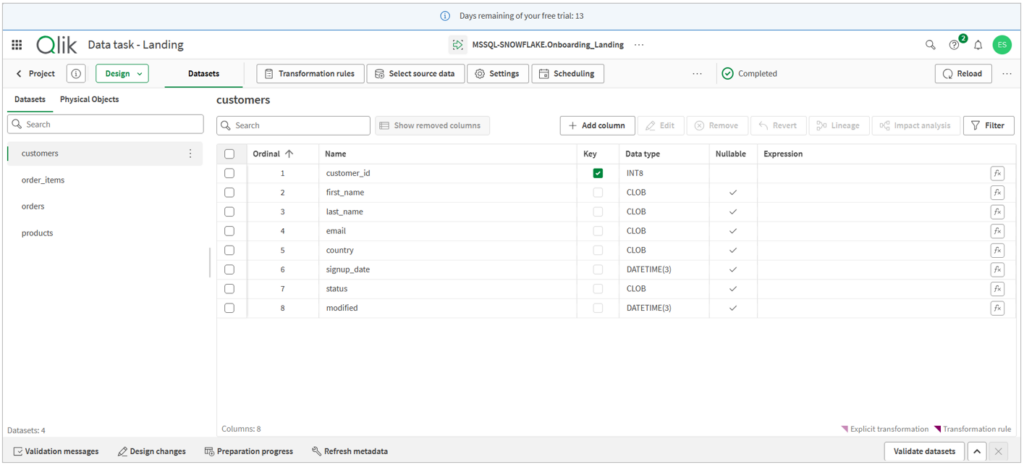

For the middle component (Onboarding_Landing), I set the same tables to replicate:
The Runtime Results

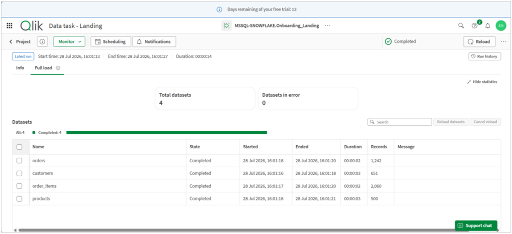

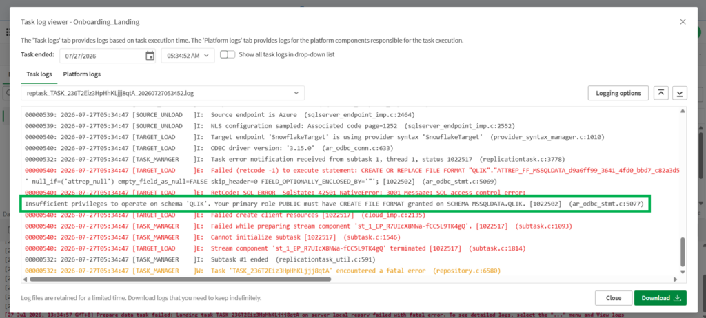

Though my Qlik Replicate setup is correct, I have to contend with permission errors. Qlik has a detailed log when an error occurs, so you have to dig in per line. I saw the permission error as having insufficient privileges in the QLIK schema in Snowflake. One of them is the following:
That’s why earlier, I mentioned additional permissions for Qlik in Snowflake, and those are CREATE STAGE and CREATE FILE FORMAT permissions. Because of these, we know that Qlik stages the SQL Server data first before writing to Snowflake tables. I have to add permissions after I made the pipeline.
Setup time: 20 minutes including debugging and adjustments to Snowflake permissions. Newbies can probably do this in an hour.
When it ran, it took 14 seconds to do the initial upload, and the row counts per table are consistent with the earlier counts in SQL Server. See below:
Pipeline runtime by Qlik

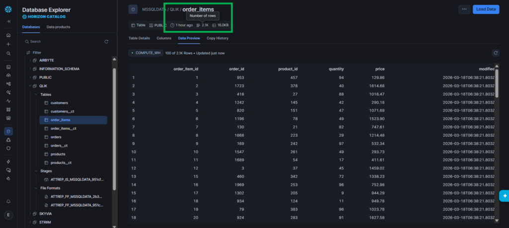

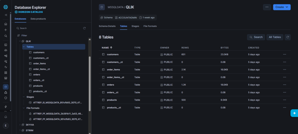

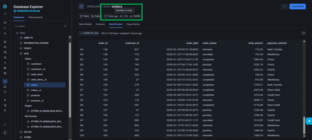

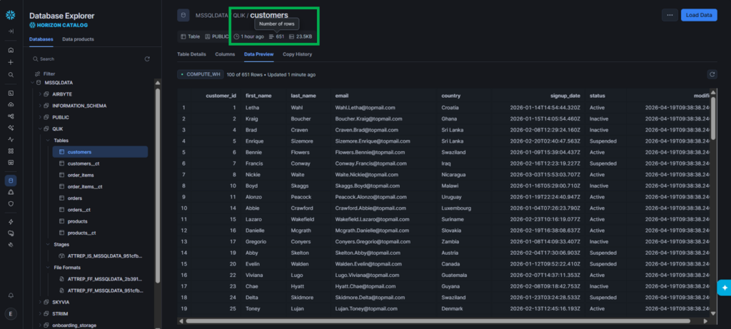

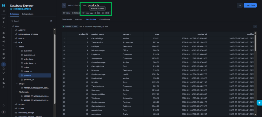

Aside from creating a stage and 2 file formats in Snowflake, Qlik also wrote 4 temporary tables (with a _ct suffix after the table name) in the QLIK schema. You can see them below.
Results in Snowflake in the QLIK schema
They were empty after the replication.

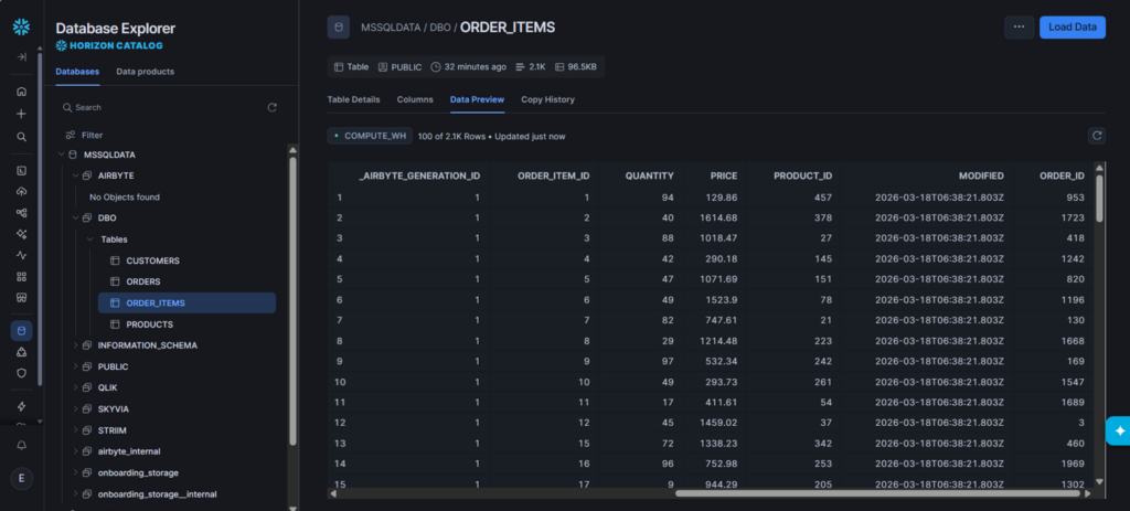

I previewed the actual tables, and below is a portion of the 651 customers:
Qlik's data preview of the uploaded customers in the Snowflake
And below is for the 500 products:
Qlik's data preview of the uploaded products in the Snowflake
Orders have 1.2K rows:
Qlik's data preview of the uploaded orders in the Snowflake
Finally, order items:
Qlik's data preview of the uploaded order items in the Snowflake
Qlik didn’t clean the temporary staging objects after processing. But it did the job.

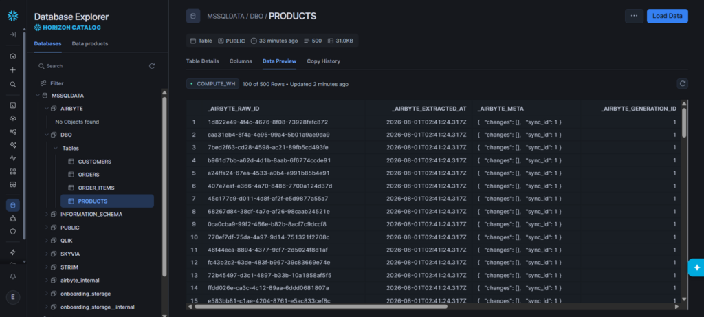

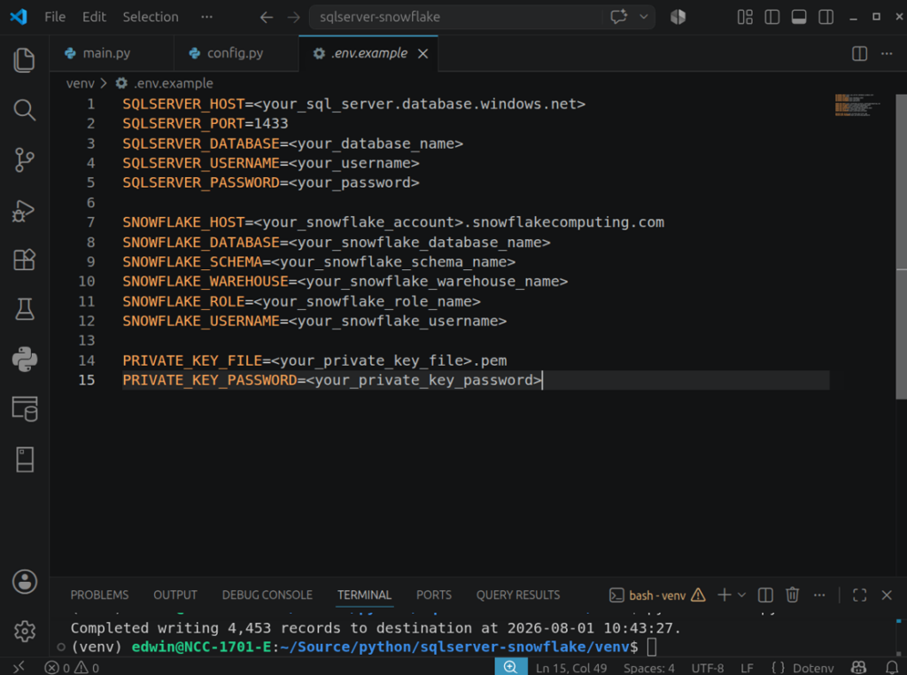

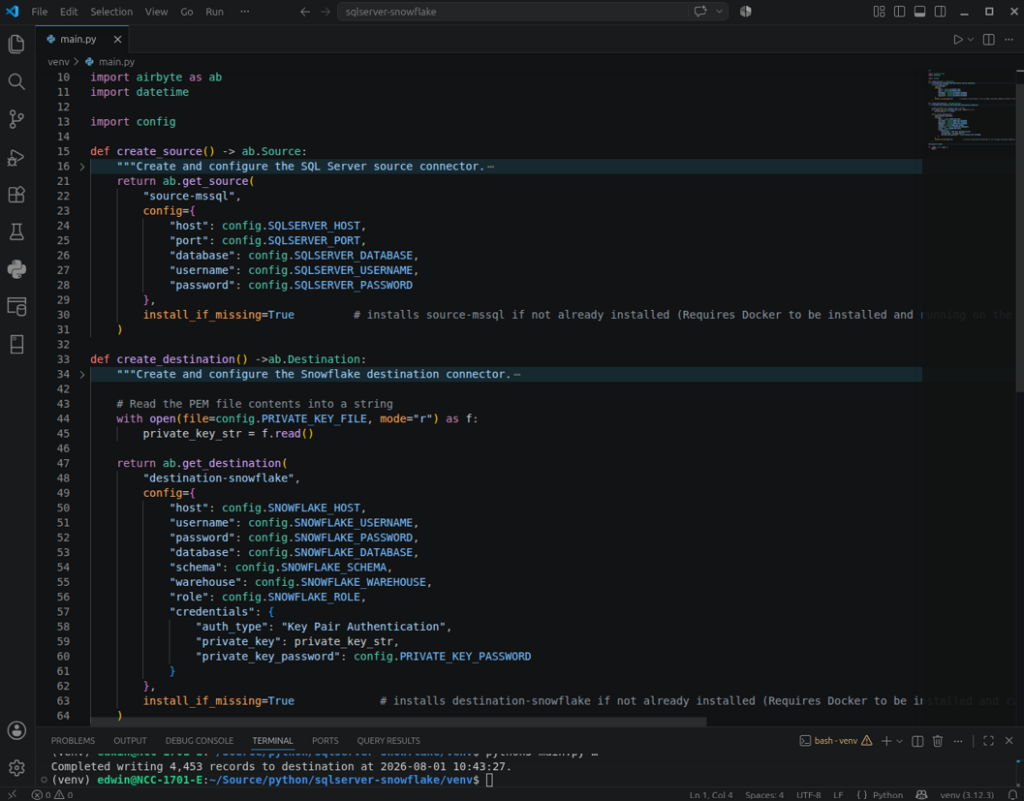

Preparing the SQL Server to Snowflake Pipeline Using PyAirbyte

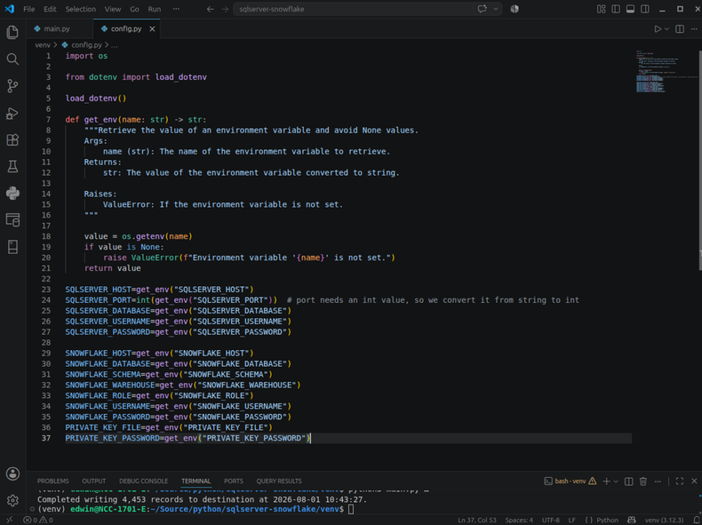

I started with the .env file for the setup configuration. You can see the sample below:
The above .env file is loaded, and each item is a Python variable. See below:

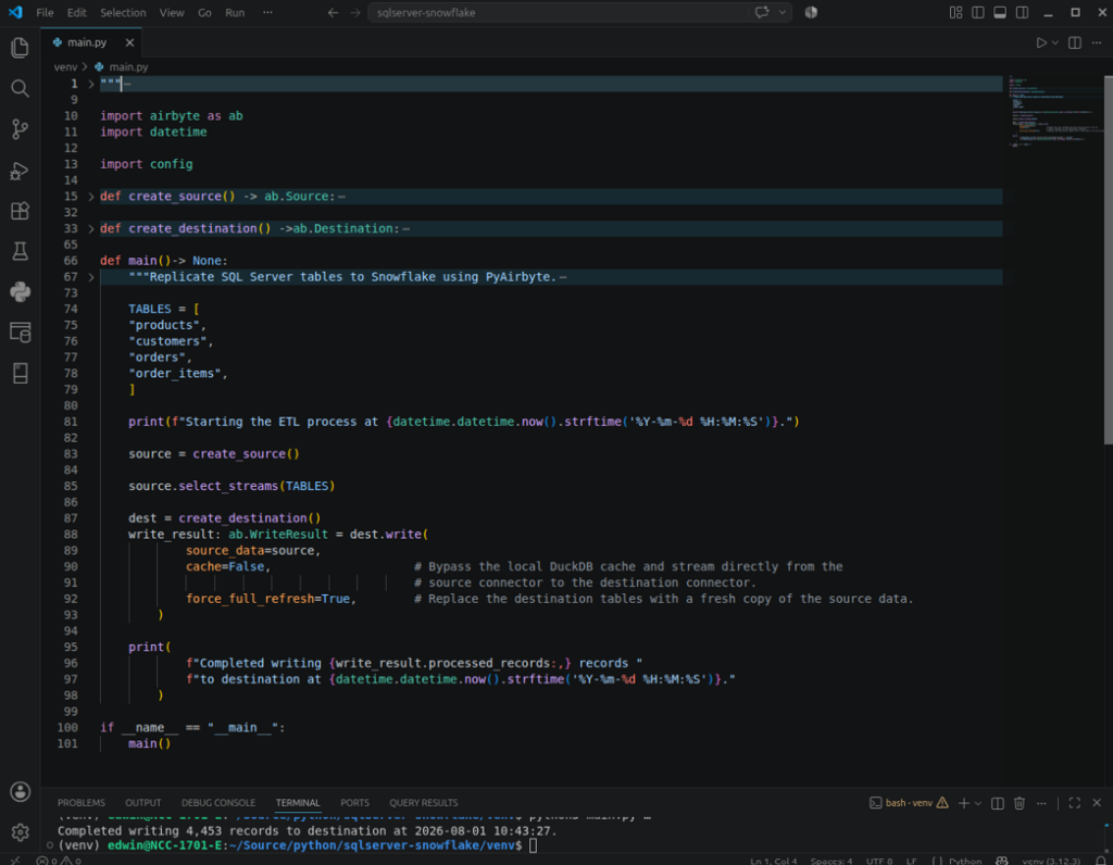

The pipeline is simple:
  • List down the tables to replicate in a Python array.
  • Initialize the SQL Server connection source using the configuration earlier.
  • Initialize the Snowflake connection destination.
  • Make a full refresh replication from SQL Server to Snowflake.
That’s it. You can see that below:
Moreover, the initialization of the source and destination are defined in two separate functions. Note the correct config parameters for Snowflake, because one missing item here will break the connection. The Private Key file is loaded separately into a string, because the Snowflake Airbyte connector will not open the file for you.
Development time: 3 days, including debugging, testing, and fixing.

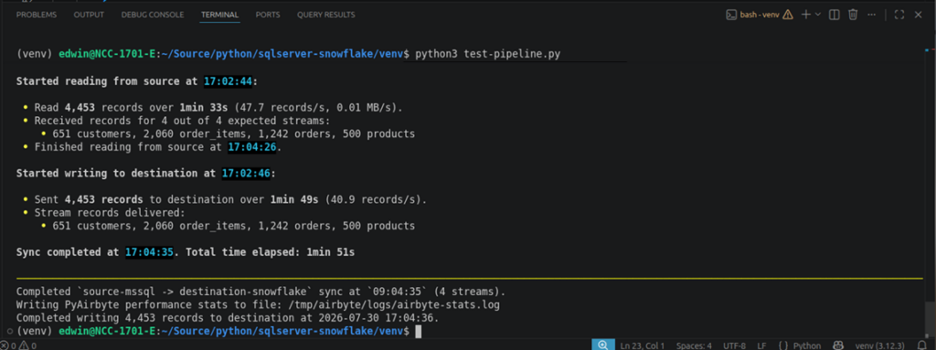

The Runtime Results
Shown below is the output in my Linux Terminal. It says it took 1 minute and 51 seconds for an initial load. However, the line in the main() function to select the streams (source.select_streams(TABLEs)) took 6 minutes. So, the actual duration was 7 minutes and 51 seconds.
the runtime results

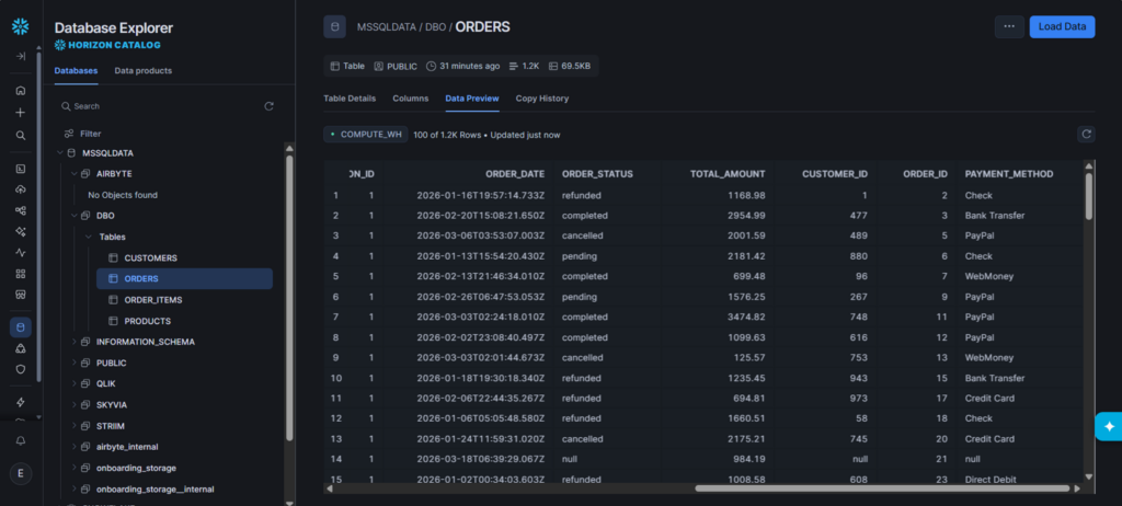

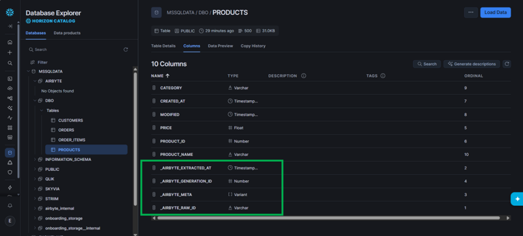

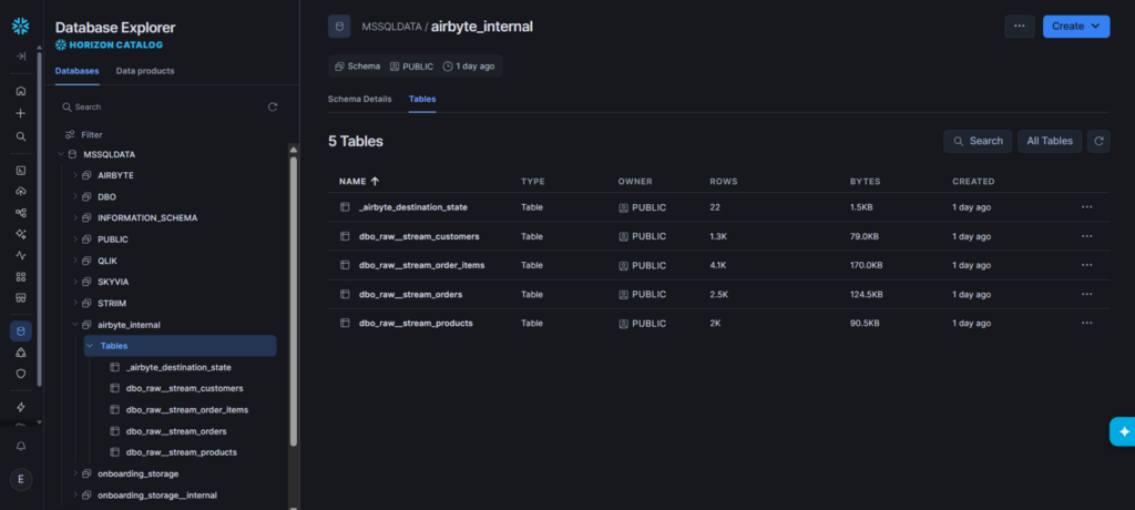

The Airbyte Snowflake destination connector staged the SQL Server data in a separate schema (airbyte_internal). Check it out below:
So, I have to provide the CREATE SCHEMA permissions for that too. That’s why extra permissions are needed for Airbyte aside from Qlik.
But here’s the catch: We wanted the results written in the AIRBYTE schema, and I defined that in the configuration. But Airbyte followed the schema from the source, which is DBO. So, the result was not written in AIRBYTE, but in the DBO schema. See it below. The AIRBYTE schema is empty, and the DBO schema has the tables.
Airbyte's data preview in the Snowflake
The written tables and their row counts are the same as what the other tools did. This is a small caveat for me. If this is alright with you, we’re in agreement that the pipeline is a success.
It also added 4 columns for each table. Most probably, this is for incremental updates later on.

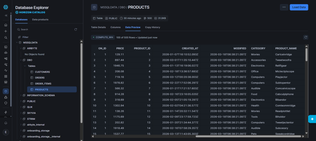

Airbyte's data preview of the uploaded products in the Snowflake
Meanwhile, below is a preview of the 500 products:
Along with the real data, the Airbyte-added columns have the following data:
Meanwhile, below is a preview of the 651 customers:
Airbyte's data preview of the uploaded customers in the Snowflake
And the 1.2K orders:
Airbyte's data preview of the uploaded orders in the Snowflake
Finally, the 2.1K order items:
Airbyte's data preview of the uploaded order items in the Snowflake

Note to developers: PyAirbyte’s default behavior is to cache the source data into DuckDB, but that one failed my test. I did a straight copy to move data from SQL Server to Snowflake.
If you want to get your hands on this Python data pipeline, you can clone my GitHub repository from here.
PyAirbyte is for developers who need flexible pipelines without reliance on an Airbyte account and want to avoid maintaining a self-hosted Airbyte Core. But if you want a fully-managed service with open-source roots, you can try Airbyte Cloud.

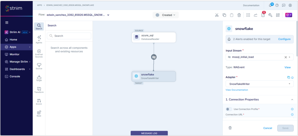

Preparing the SQL Server to Snowflake Pipeline Using Striim

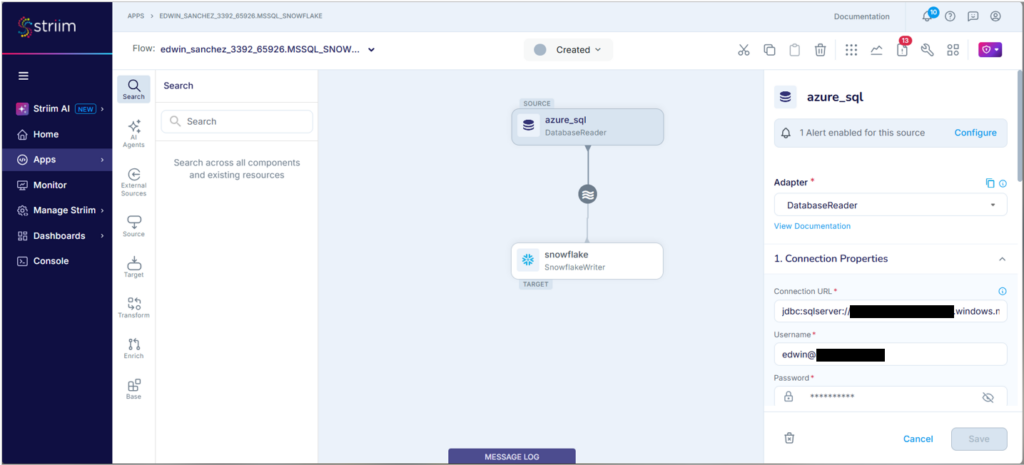

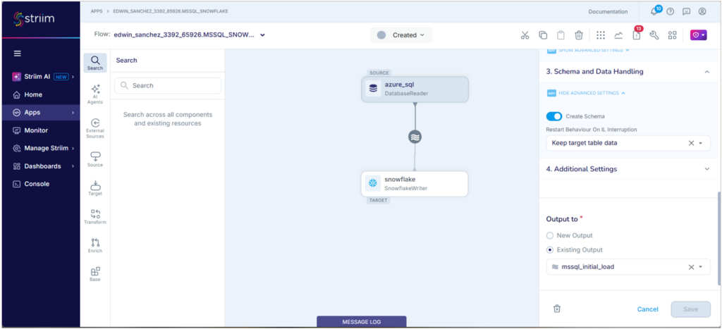

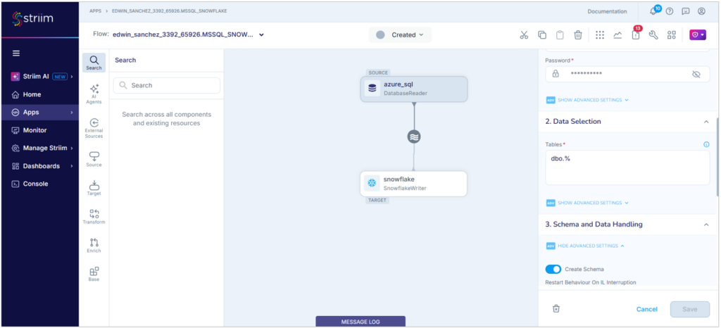

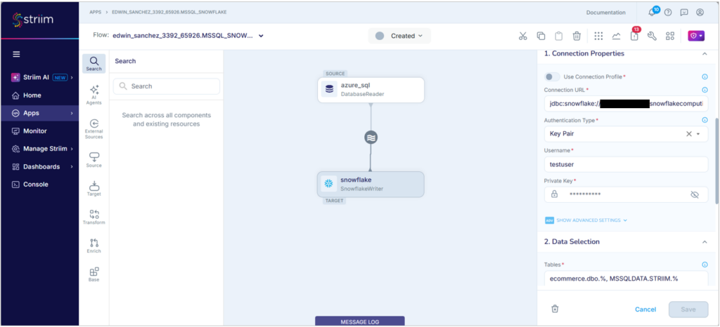

Designing the pipeline in Striim is graphical. You drag and drop a source and a connector, connect the two, and configure each.
Striim uses a few reader adapters for SQL Server, but I used the DatabaseReader. I can’t make the others work. Setting up connections is through JDBC. This is somewhat a developer’s way of connecting, but for me, the instructions are clear.
I used the same SQL Server configuration below:
Striim Azure connector
The difference is in the username. It should be in the format <username>@<instance_name>. Using username only will fail.
Choosing the tables may not be so friendly with non-techy people. As per instructions, I type the table names in a box, or use schema + wildcards. I used dbo.* as seen below, meaning all tables under the dbo schema. You should also enable Create Schema.
Moreover, you need to name the output. I used the name mssql_initial_load. This will be used as the input in the Snowflake destination.
For Snowflake, it starts by specifying the input (mssql_initial_load) from the output of the SQL Server source. Then, specify the SnowflakeWriter adapter.
Striim Snowflake connector
The connection string is also in JDBC format. The rest of the credentials are the same as the other tools.
The one that confuses me at first is the Tables selection. It should be in the format <source database>.<source schema>.<table name or wildcard>, and its counterpart in the target, which is formatted as <destination database>.<destination schema>.<table name or wildcard>.
It took me a while following the Striim docs, but in the end, this setup is correct.

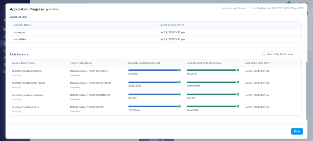

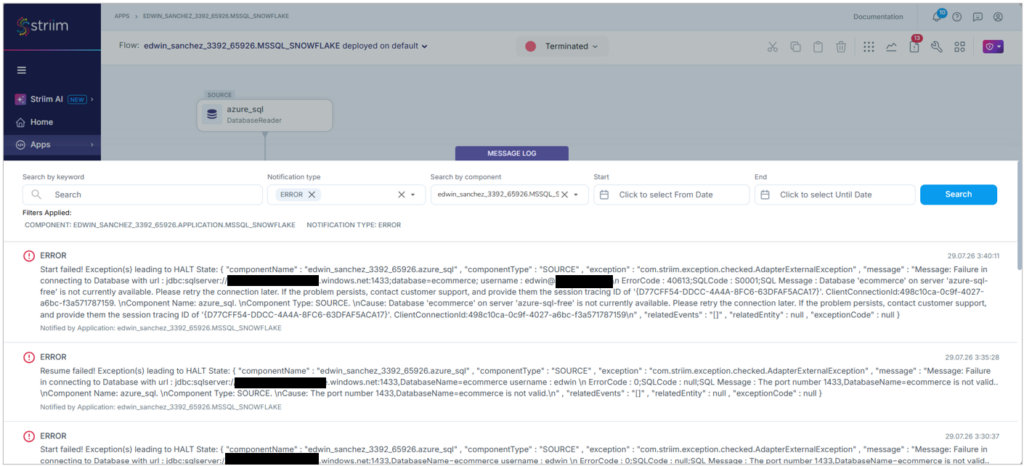

The Runtime Results
I had 10 errors before I made it right. Three of them are shown below:
Striim data progress errors
The error is not what it seems. For example, from the above, I got the “port number 1433 … is not valid.” That port number used to work with the other tools. In the end, the username format is to blame. I used the format <username> at first. It was good when I changed it to <username>.<instance name>.
When I finally got it right, I deployed it, and it ran for 12 minutes (see the green box below).
Striim data application progress
The replicated tables and their row counts are the same as with the other tools.
Setup time: 2 hours, including debugging.

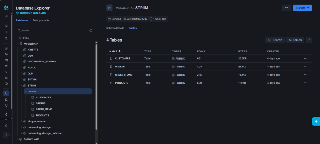

Were the tables replicated in Snowflake under the STRIIM schema? It did, as you can see below.
Striim's data preview in the Snowflake
I preview the 651 customers, and it’s there.

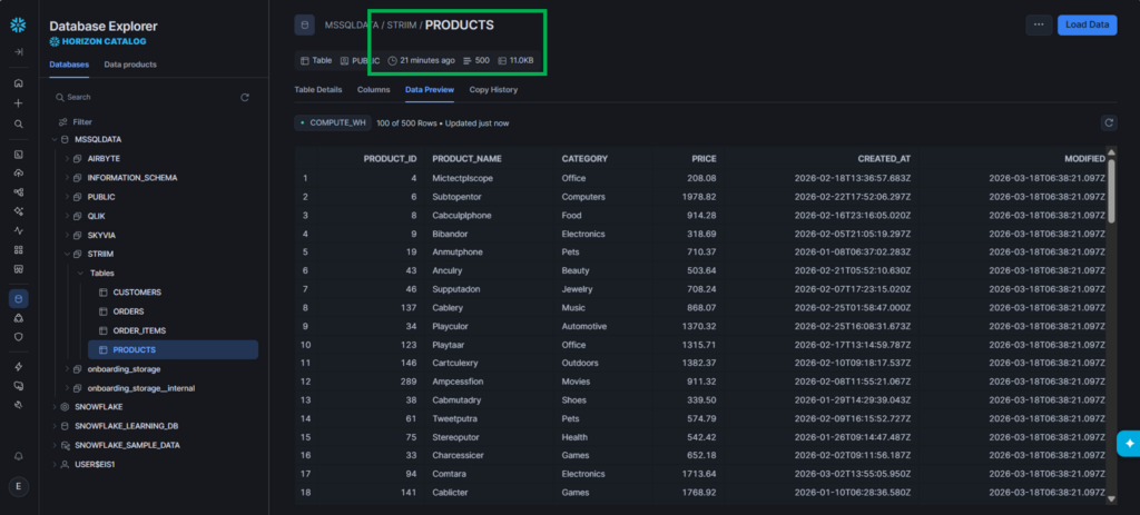

Also, the 500 products:
Striim's data preview of the uploaded products in the Snowflake
Then, the 1.2K orders:
Striim's data preview of the uploaded order in the Snowflake
And finally, the order items:
Striim's data preview of the uploaded order items in the Snowflake

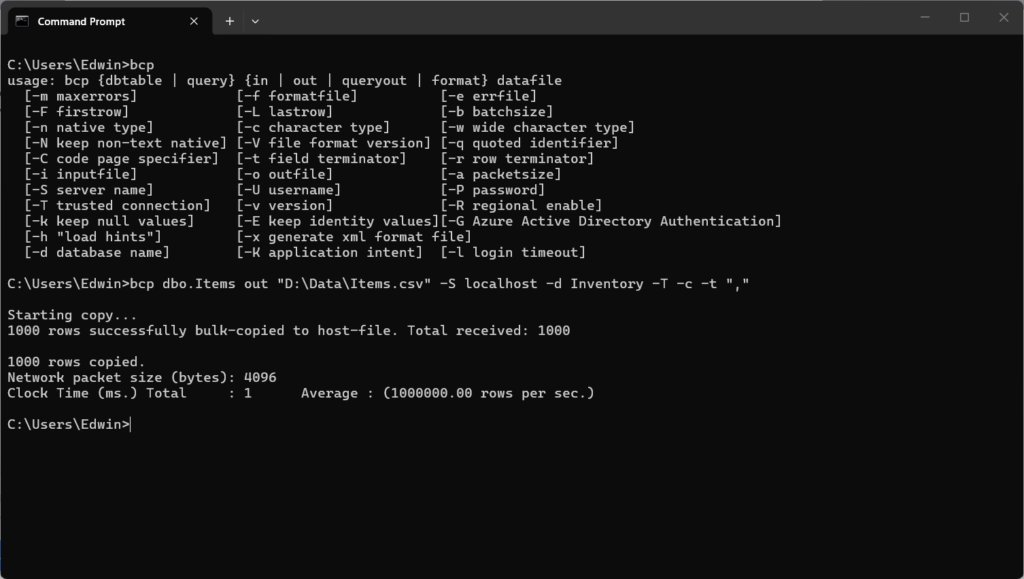

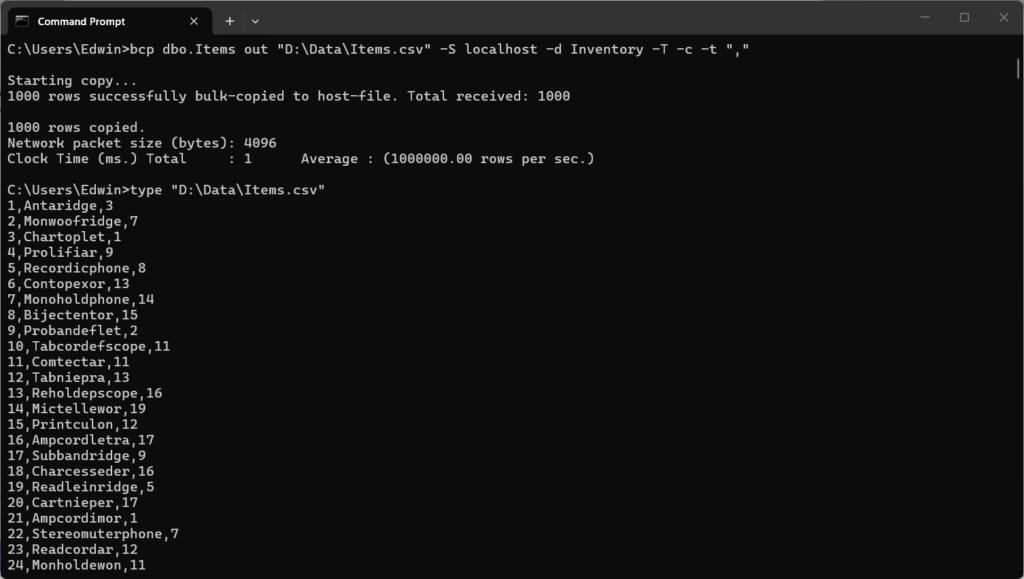

Below is what I did using BCP:
Syntax:
BCP <table name> OUT "<target path and filename.CSV>" -S <your SQL Server instance> -d <database name> -T -c -t ","
Open the Terminal or the Command Prompt and follow the syntax above. The -T parameter means it will use my Windows account to connect to the database. If you don’t have that, use – U <your SQL Server username> and -P <your password>. Contact your database administrator to know which one applies to you. The -t “,” simply tells BCP that each column should be delimited by a comma.
Below is a sample from my own setup.
preview of the data in the Terminal
It exported 1000 rows of inventory items into Items.CSV. Below is a preview of the data in the Terminal:

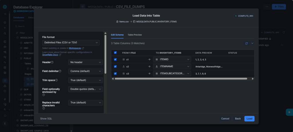

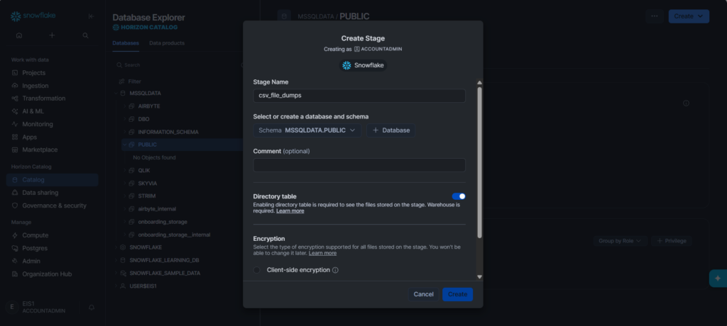

In Snowflake, I created a stage using the web UI:
In Snowflake, a stage created using the web UI
Using the web UI, I uploaded the file by clicking the + Files button, then dragging the CSV file into the prompt. Then, I uploaded the CSV file to the target table. I have to specify that there’s no header, the delimiter is a comma, and then map the values into my table columns. Finally, click Load. Here’s a sample:
Load data into table using SQL Server to Snowflake Manual Methods

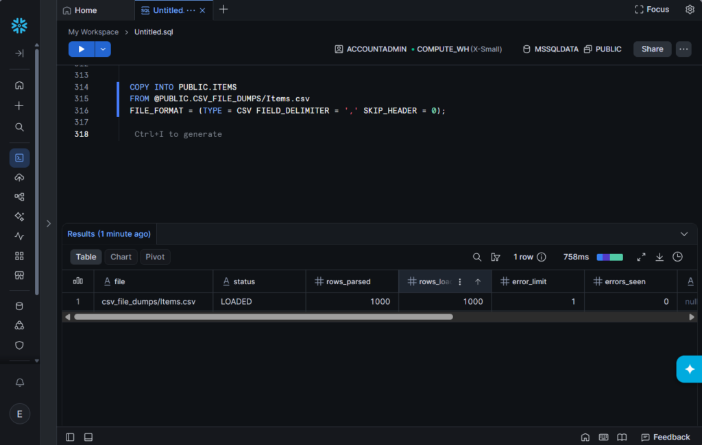

Alternatively, this can be done using COPY INTO. Here’s what I did:
COPY INTO Using SQL Server to Snowflake Manual Methods
The important elements here are the target table (Items table), the stage name and the path/filename of the CSV file, and the formatting options. I used the same formatting as the web UI: No header (SKIP_HEADER=0) and comma-delimited (FIELD_DELIMITER=”,”).

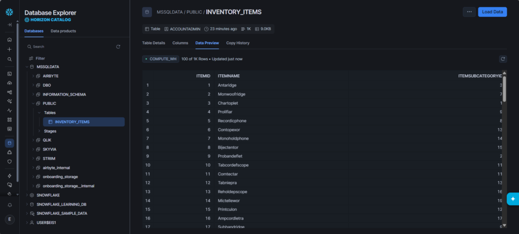

Here’s the result of the uploaded CSV using the web UI:
the result of the uploaded CSV:  INVENTORY_ITEMS
It’s similar to the COPY INTO, but the table name is different (ITEMS instead of INVENTORY_ITEMS).
