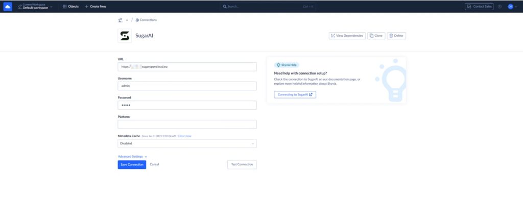

The starting point is two connections — one to SugarAI, one to S3. You click +Create New → Connection, select SugarAI, enter your instance URL and credentials, and you’re authenticated.
SugarAI Connection in Skyvia

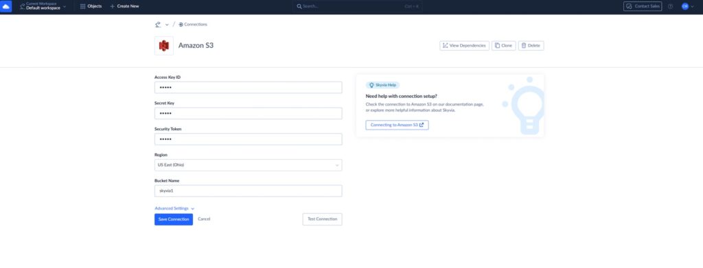

Same for S3 — select the connector, drop in your bucket name and AWS credentials, save.
S3 Connection in Skyvia

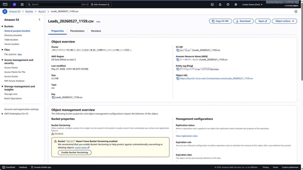

From there, you create an integration and add the CSV export task. You select the Leads module as your source, point it at your S3 bucket as the target, and Skyvia pulls the available fields automatically.
You configure your filters, set a sync schedule anywhere from every minute to once a day, and run it. The output lands in your S3 bucket as a clean CSV.
Skyvia export
The whole setup takes under fifteen minutes for a first run with no prior Skyvia experience. The second run takes five.

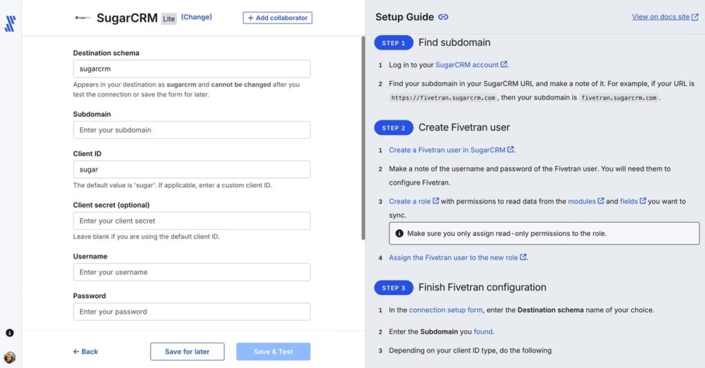

The starting point is familiar — you connect SugarAI as a source and S3 as a destination through Fivetran’s connector library. Authentication is straightforward: OAuth for SugarAI.
Fivetran connector setup screen showing SugarAI source configured

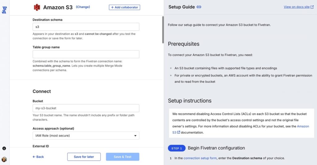

Then bucket credentials for S3. No infrastructure to manage, no Docker containers, no YAML files.
Fivetran connector setup screen showing S3 destination configured.

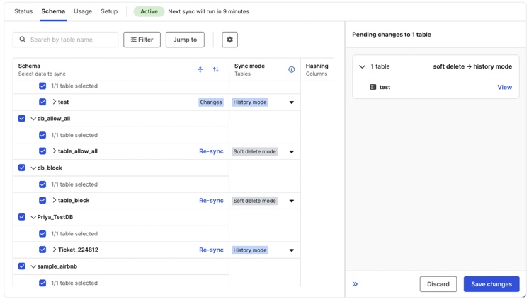

Here, Fivetran automatically detects your SugarAI schema (Accounts, Contacts, Leads) and maps everything to your S3 destination without asking you to touch the field configuration manually. This is where Fivetran earns its reputation: the pipeline practically builds itself.
Fivetran schema changes
We deliberately changed part of the SugarAI schema mid-sync during testing — the kind of thing that happens in real CRM environments when someone adds a custom field or renames a module. Fivetran caught the change, updated the destination schema automatically, and kept the pipeline running. No manual intervention, no broken sync, no Tuesday morning support ticket.
The whole setup is fast. But more importantly, once it’s running, it mostly stays running — which is the thing enterprise teams actually care about once pipelines move into production.

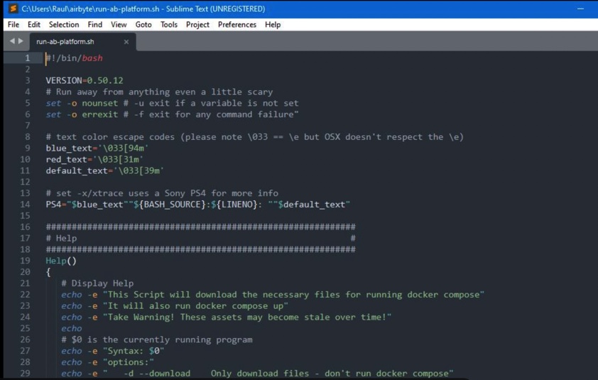

The starting point is different from every other tool in this guide. Before you connect anything, you need a running Airbyte instance — which means Docker, a server to run it on, and someone who’s comfortable with both. If that sentence just made you slightly nervous, scroll back up to the Skyvia section.
Airbyte Docker connection

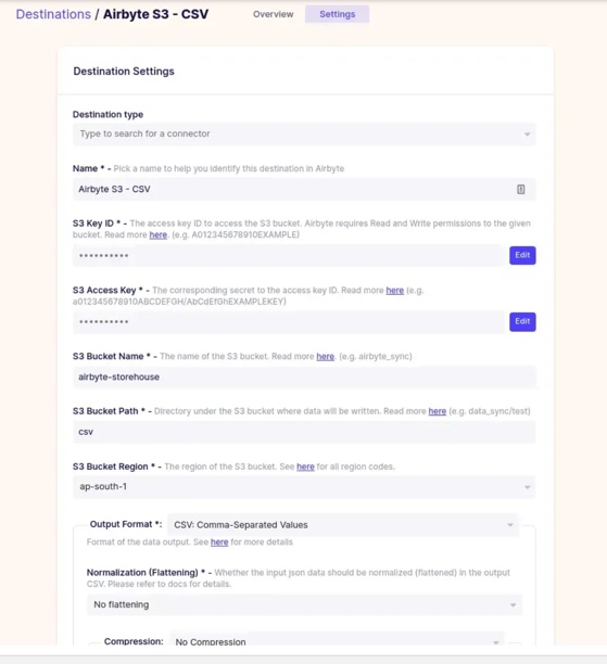

Once the instance is up, you connect to SugarAI’s underlying MySQL database as the source and S3 as the destination. You’ll need your database host, port, credentials, and direct access to the SugarAI schema. This is database-level access — you’re not selecting objects through a friendly UI, you’re querying tables directly.
Airbyte S3 settings
From there, you’ll configure which tables to sync, set your sync frequency, and point the output at your S3 bucket. The data lands in S3 as raw database tables rather than CRM-structured objects, which means some transformation work is usually needed downstream to make it useful for analytics.
Working at the database layer means you’re not browsing a list of “Leads” and “Contacts” — you’re looking at raw table names like accounts, calls_cstm, and prospect_lists_prospects. If you know the SugarAI schema well, that’s manageable. If you don’t, expect to spend time in the VarDefs documentation before you sync a single useful row.

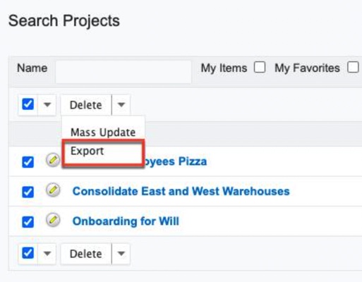

There’s nothing to install and nothing to configure. Inside SugarAI, you navigate to the module you need — Contacts, Leads, Accounts, Reports — apply whatever filters you want, hit Actions → Export, and a CSV lands in your downloads folder.
SugarAI interface showing the Actions → Export button in the Contacts or Reports module

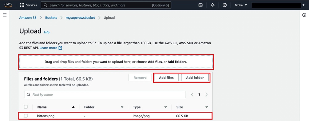

From there, you open your S3 bucket in the AWS console, click Upload, and drag the file in.
AWS S3 console open with the exported CSV being manually uploaded
That’s the entire process. Two screens, zero cost, five minutes.
