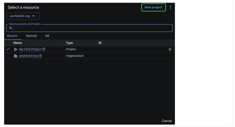

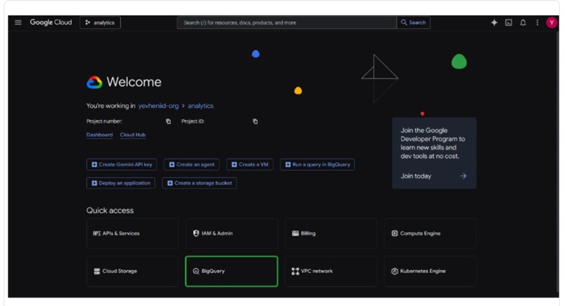

First, open Google Cloud Console and create a new project, or choose an existing one. If you are creating a fresh project, give it a name that will still make sense later, for example, ga4-bigquery-export or marketing-analytics-bq.
Google Cloud project picker with New project button
After the project is created, enable BigQuery for it. In Google Cloud, open APIs & Services, go to Library, search for BigQuery API, and click Enable. Google lists this as the first setup step before linking Analytics to BigQuery.
Google Cloud BigQuery API enabled for the selected project

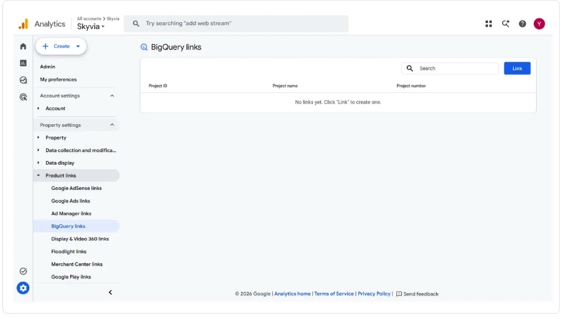

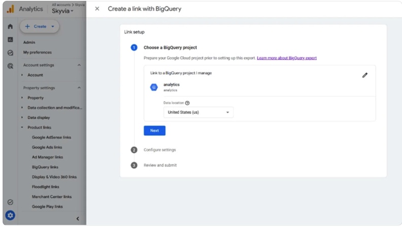

Then go back to Google Analytics. Open Admin, find Product Links, and choose BigQuery Links. Click Link.
GA Admin panel showing Product Links and BigQuery Links
In the setup window, choose the BigQuery project you just created. After that, select the data location. This part is easy to rush, but do not treat it like a random dropdown. If your company has regional data requirements, choose the region carefully because changing it later is not a clean switch.
GA BigQuery link setup with selected BigQuery project and data location

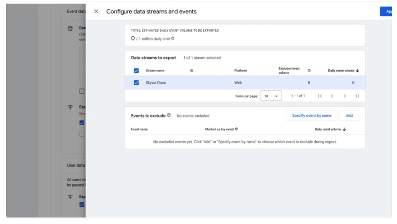

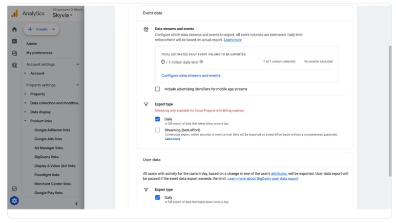

Next, choose which data streams to export. You can also exclude specific events if you do not want everything going into BigQuery.
GA BigQuery link setup showing data streams and event exclusion settings
Finally, choose the export frequency. GA supports Daily export and Streaming export, and Google Analytics 360 properties also have the Fresh Daily option. Daily export sends the previous day’s data once per day. Streaming export sends data continuously into intraday tables.
GA export frequency settings with Daily and Streaming options

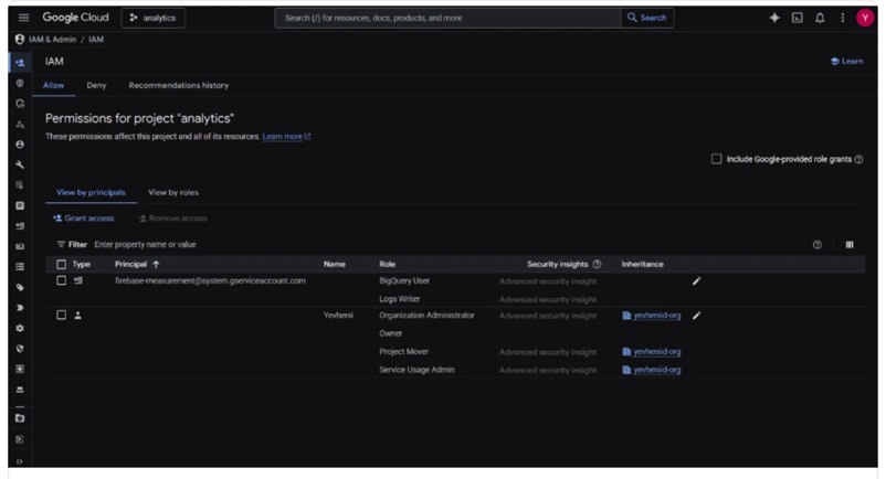

After you review and submit the link, Google Analytics creates the connection. You can also verify the service account in Google Cloud IAM. Google’s docs name the service account as firebase-measurement@system.gserviceaccount.com.
Google Cloud IAM showing firebase-measurement service account.j
Once the link is complete, data should start appearing in BigQuery within 24 hours. Daily exports create events_YYYYMMDD tables, while streaming exports create events_intraday_YYYYMMDD tables that are populated during the day.

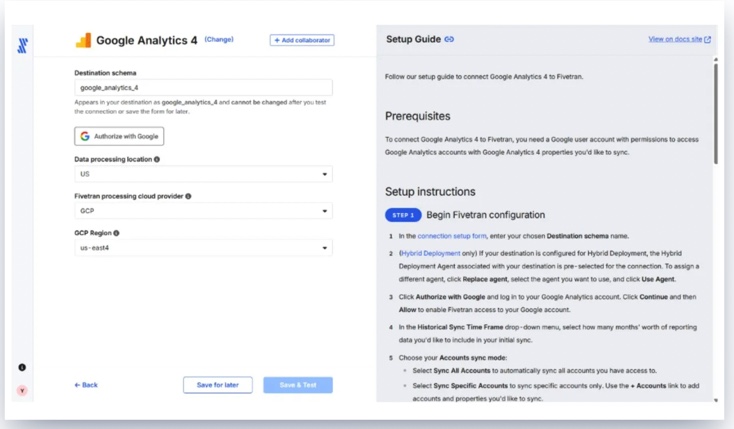

Fivetran is the “we have a data team and a serious budget” option in this group. It is built for managed data movement at scale, with a large connector catalog, strong automation, and less day-to-day pipeline maintenance than a homegrown setup.
For Google Analytics to BigQuery, that means Fivetran can take care of the connector, schema updates, loading behavior, and sync monitoring without your team writing API scripts. That is useful when GA data is only one part of a bigger enterprise warehouse setup with CRM, ads, product, finance, and support data flowing into BigQuery.
The price is the part I would watch closely. Fivetran bills around Monthly Active Rows, so traffic volume is not the only thing that matters. Updates, changes, and high activity can all affect the bill. For a smaller GA setup, that may be fine. For a busy website, it is worth modeling the cost before calling the pipeline “hands-off.”
Fivetran connector setup dashboard for Google Analytics to BigQuery pipeline.j

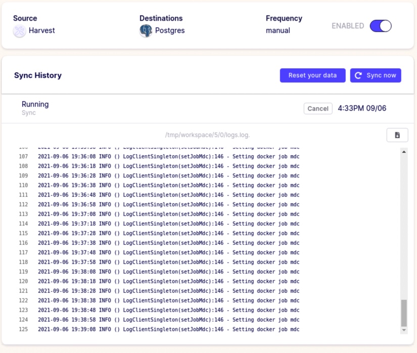

Airbyte is the option for teams that prefer more control over having everything managed for them.
For Google Analytics to BigQuery, Airbyte is useful when your team wants more control than a fully managed tool gives you. You can self-host it, see more of what the connector is doing, and adjust the setup around your own infrastructure. The catch is that someone has to be ready to own that control when a sync fails or a container needs attention.
The open-source version is free to start with, but somebody still has to own it. In our self-hosted test, getting Airbyte running was manageable. Keeping it healthy was the bigger question. Containers need a place to run, updates need attention, failed syncs need review, and logs need a person who knows what they are looking at.
Airbyte Sync History screen showing Docker job log messages during a manual sync

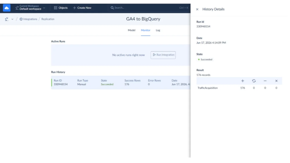

Best for No-Code Teams: Skyvia
Skyvia sits in the middle of this list. It is easier to run than Airbyte, less engineering-heavy than a custom setup, and much easier to budget than enterprise tools built around active-row pricing.
That matters because the person who needs GA data in BigQuery is not always a data engineer. It may be a marketing analyst cleaning up campaign reports, a RevOps manager matching web activity with Salesforce leads, or a BI lead who just needs the data to arrive without turning the whole thing into a coding task.

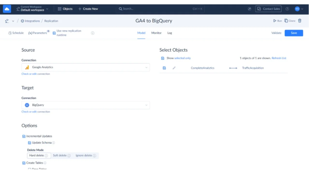

In Skyvia, the setup is closer to filling out a clear workflow than building a pipeline from scratch. You connect Google Analytics and BigQuery, choose the data to move, set the schedule, and then watch the run from the dashboard. It works well for teams that need GA data in BigQuery but do not want the export process to become its own engineering project.
Sku=yvia GA to BigQuery

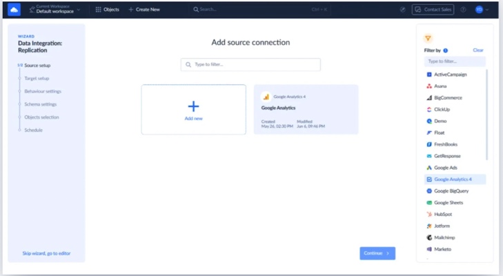

Skyvia does not send you straight into raw GA event tables. It pulls Google Analytics data via Google’s API, lets you choose the dimensions and metrics you need, and loads the results into BigQuery as easier-to-work-with tables.

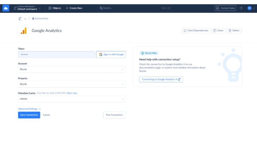

Step 1: Create your Google Analytics connection
In Skyvia, create a new connection and choose Google Analytics. Sign in with the Google account that has access to the GA property, then select the property you want to use.

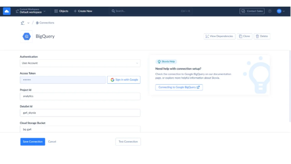

Step 2: Connect BigQuery as the destination
Next, create a Google BigQuery connection. Enter the project ID, dataset ID, and Google Cloud Storage bucket used for staging. The dataset and bucket should already exist in Google Cloud before you configure the connection.
kyvia Google BigQuery connection setup with project dataset and Cloud Storage bucket.
Step 3: Create the replication scenario
Create a new Replicatiion. Select Google Analytics as the source and choose BigQuery as the destination. Then select the GA object you want to load, such as CompleteAnalytics, and choose the dimensions and metrics for the target table.
For example, a traffic acquisition table might include:
Dimensions: Date, SessionDefaultChannelGroup, SessionSource, SessionMedium, SessionCampaignName, DeviceCategory
Metrics: Sessions, EngagedSessions, TotalUsers, NewUsers, KeyEvents, TotalRevenue
One practical GA limit shows up here. You can choose up to 9 dimensions in a Skyvia replication task, so it is better to build focused tables instead of one oversized “everything” table. For example, one task for traffic acquisition, another for landing pages, another for e-commerce. Metrics are less painful: if you select more than 10, Skyvia can make the extra API calls and load them for you.
After that, click Save , run it, and check the result in BigQuery.

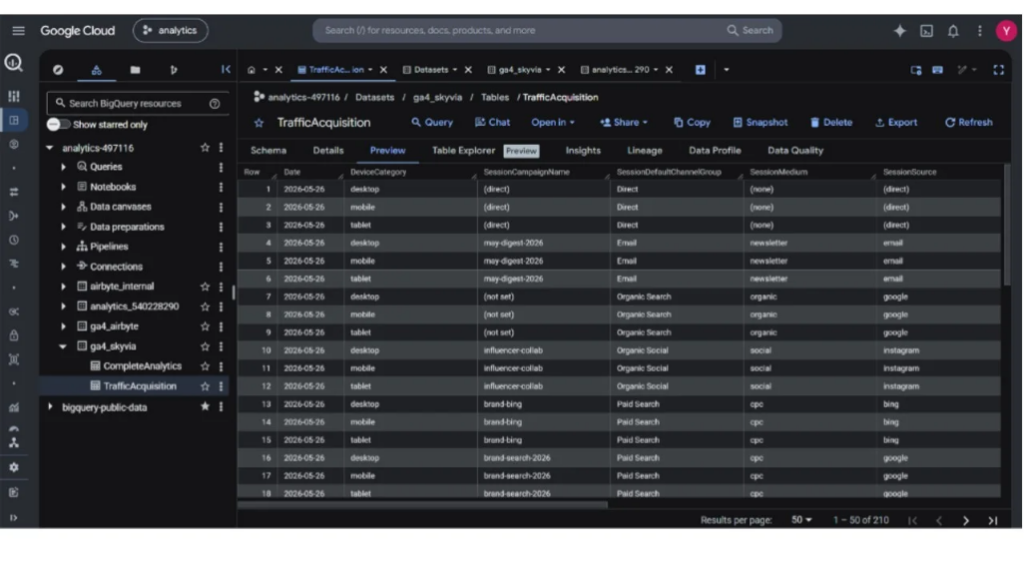

The “Aha!” Moment: Raw Native Export vs Clean Reporting Table
This is where the difference becomes easier to see.
The native GA export is useful, but it lands in BigQuery as raw event-level data. Important details often sit inside nested fields like event_params, so even a basic page or campaign report may require UNNEST queries.
With Skyvia, you define the reporting table during setup. The selected dimensions and metrics land as regular columns, so analysts can query them with a much simpler SQL statement.
BigQuery table preview showing Skyvia-loaded Google Analytics traffic acquisition data as flat columns.
A native GA query may look like this:
SELECT
 event_date,
 event_name,
   SELECT value.string_value
   FROM UNNEST(event_params)
   WHERE key = 'page_location'
 ) AS page_location
FROM `project.dataset.events_*`
WHERE event_name = 'page_view';
A Skyvia-loaded reporting table can be queried more directly:
SELECT
 Date,
 SessionSource,
 Sessions,
 EngagedSessions,
 TotalUsers
FROM `project.dataset.TrafficAcquisition`
ORDER BY Date DESC;

That is the main reason to use Skyvia here. It is not trying to replace every raw-event use case. It is for teams that want Google Analytics data in BigQuery in a form people can actually work with, without turning every report into a nested SQL exercise.
