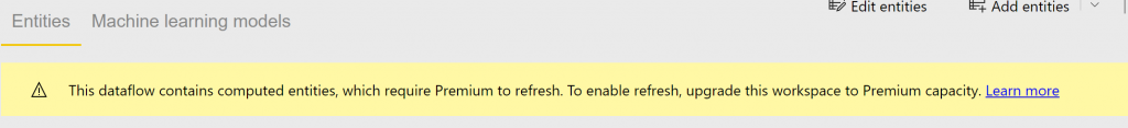

Computed Tables go a step further. They allow you to perform transformations inside the dataflow storage itself, not at the source. That means joins, aggregations, and reshaping are computed once and cached for downstream use.
In practice, you’d use a Linked Table to pull in a shared dataset, then a Computed Table to transform it further – all without going back to the source.
Computed Tables require Premium capacity or PPU – on a standard Pro license, you’re working in shared capacity, where this feature simply isn’t available. You won’t get far before Power BI tells you so.
Power BI warning banner stating that computed entities in the dataflow require Premium capacity to refresh

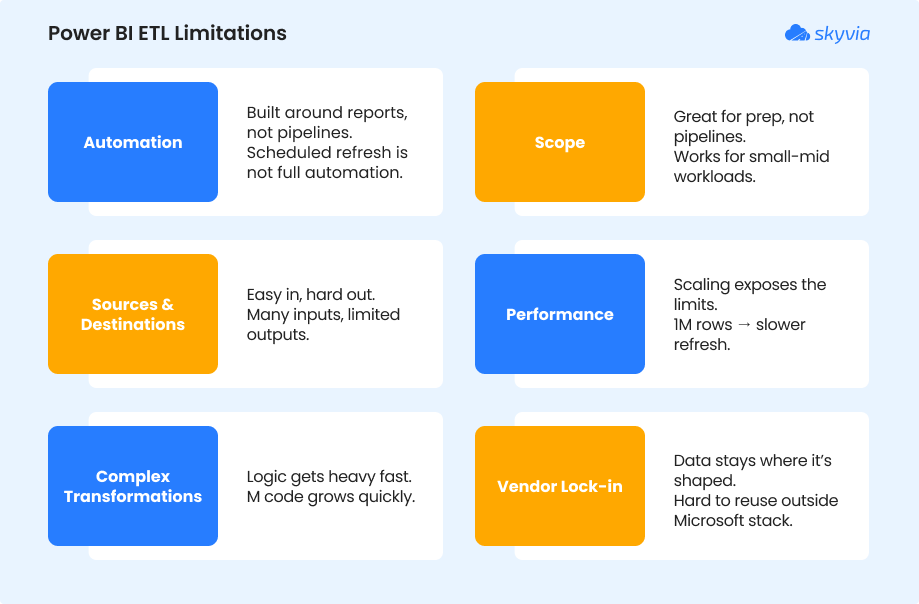

The Breaking Point: ETL Challenges in Power BI
Most of the issues regarding applying ETL in Power BI don’t show up at the start. They appear later, when datasets get larger, refreshes take longer, and teams need to reuse the same transformations.
Skyvia infographic titled "Power BI ETL Limitations" displaying six key challenges
Automation
ETL inside Power BI remains connected to analytics workflows even with Microsoft Fabric. Refreshes can be scheduled, but independent pipelines are not being built. Reports continue to be the main focus of the process rather than data flow as a standalone system.
Scope
Think three sources – a CRM, a flat file, and a SQL database – feeding one report, with dependencies between queries. In Power Query, that’s three separate connection logic blocks, no shared orchestration, and refresh failures that are painful to trace.
Sources and Destinations
Power BI pulls from many places, but it doesn’t send data back out in the same way. Most flows end inside Power BI or Azure storage. If you need to push transformed data into systems like Salesforce or HubSpot, you’re outside its comfort zone.
Performance
That’s when things start to stand out. It feels good to have a dataset with a few hundred thousand rows. Refresh times begin to rise, push over the million mark, and add joins or computed columns. Long refresh cycles or reports that seem stalled mid-load are common in actual situations. The logic is handled by Power Query, yet it has trouble processing high quantities locally without compromising.
Complex Transformations
Basic cleaning is uncomplicated. However, things get more difficult to handle as transformations become layered, including many joins, conditional logic, and dependencies between processes. Debugging becomes manual as the M code increases, and minor adjustments might affect the query as a whole.
Vendor Lock-in (The Quiet Constraint)
Data shaped inside Power BI tends to stay there. Once transformations live in Power Query or Dataflows, moving that logic elsewhere isn’t simple. There’s no clean way to take that prepared dataset and push it into non-Microsoft systems. Over time, that creates a subtle dependency on the platform.
You can work around some of this. Better data modeling, incremental refresh, and pushing transformations upstream all help. But at some point, the effort shifts from analysis to maintenance.
Usually, that’s the indication.

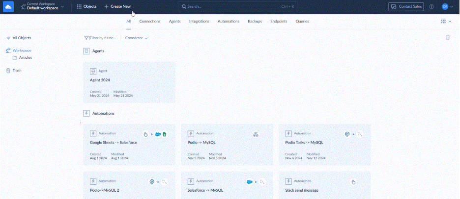

STEP 1: Connect to the Source
  1. Log in to Skyvia or create an account. If you still don’t have one, signing up takes less time than it took to read this sentence.
  2. Go to +Create New->Connection and select the source from the list.
Animated GIF demonstrating how to create a new connection in Skyvia, starting from the Default Workspace dashboard where existing agents and automations are visible
  1. Specify your credentials.

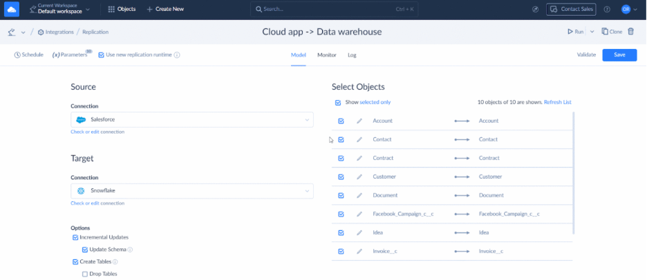

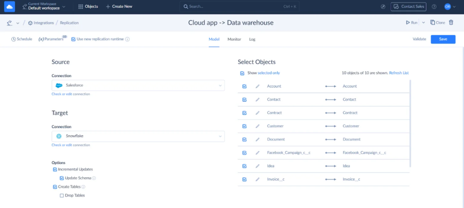

STEP 2: Load Cloud Data to Data Warehouse
  1. Go to +Create New->Replication in the top menu.
  2. Select the app of your choice as a source.
  3. Select a preferred data warehouse as a destination. Skyvia supports Amazon RedShiftGoogle BigQueryAzure Synapse AnalyticsSnowflake, and other popular data warehouse platforms.
  4. Select the objects for replication.
Skyvia's "Cloud app to Data warehouse" replication setup showing Salesforce selected as the source connection and Snowflake as the target
  1. Configure objects for replication on the right. Click Edit to open the task editor for an object. Here, you can select specific fields to replicate, set the target table name, and specify replication settings.
Animated GIF demonstrating how to edit a replication task in Skyvia's task editor

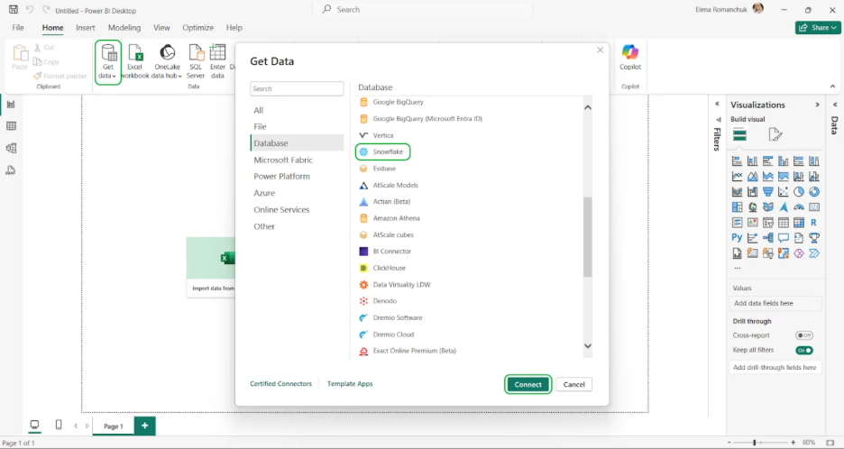

STEP 3: Load Data into Power BI
Power BI offers native integration with central data warehouses. You can transfer the recently uploaded information from the data warehouse (in this example, Snowflake) to Power BI.
  1. In Power BI, select Get Data and type Snowflake in the search bar.
  2. Select Snowflake from the list, then click Connect
Screenshot of Power BI Desktop's "Get Data" dialog opened to the Database category

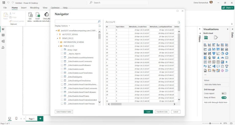

  1. Enter your Snowflake credentials.
  2. Once you establish the connection, the Navigator window with available objects on the server appears. Select the required source objects, then click Load to import them into Power BI Desktop.
Screenshot of Power BI Desktop's Navigator dialog showing a connected Snowflake database with the DEMO_DB schema expanded

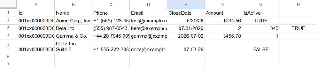

As we’ve just observed, Skyvia perfectly carries out data warehousing scenarios with ELT. Before transformation, the data looks like this:
Screenshot of a spreadsheet showing raw pre-transformation CRM data

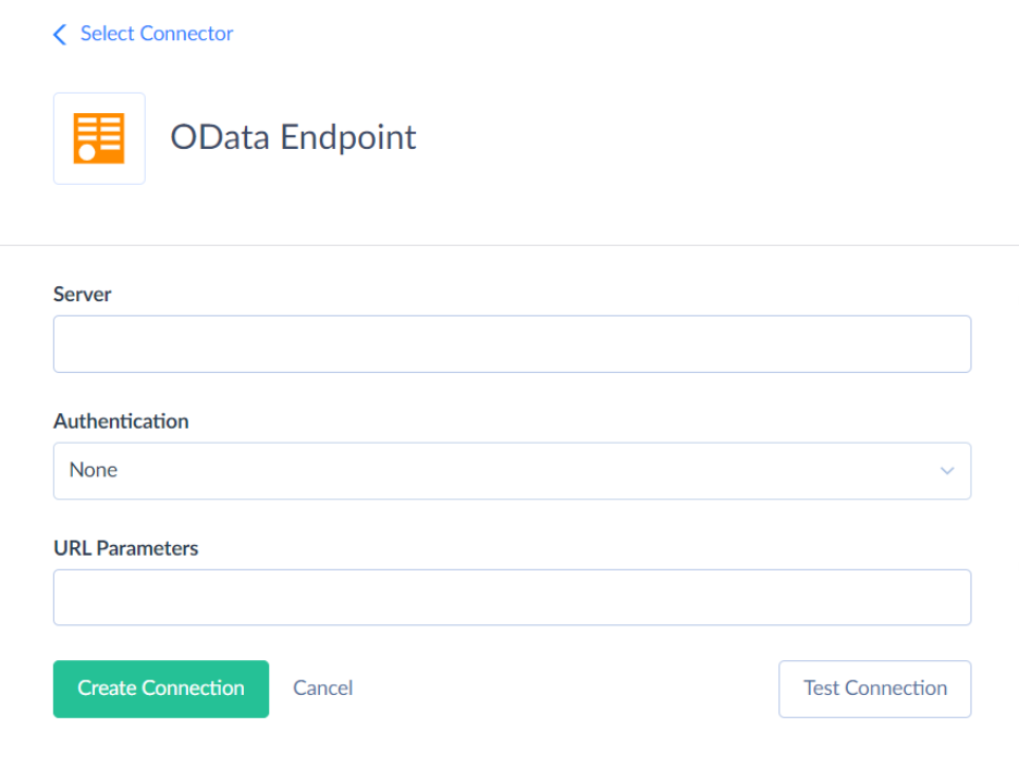

Live Access Without Pipelines: Skyvia Connect
If replication feels like too much, there’s a lighter option. With Skyvia Connect, you publish Salesforce data as an OData endpoint and connect Power BI to it directly.
Quick setup:
  1. Click +Create New in the menu, then create a Salesforce connection in Skyvia.
  2. Create a new OData endpoint.
Screenshot of Skyvia's OData Endpoint connection setup form

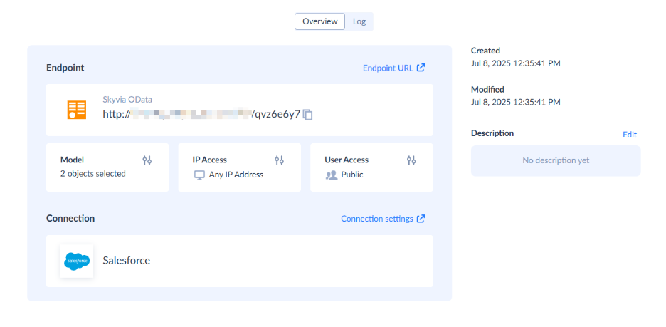

  1. Select objects and fields to expose.
  2. Copy the endpoint URL.
Screenshot of a Skyvia OData Endpoint overview page
  1. Use Get Data → OData Feed in Power BI.

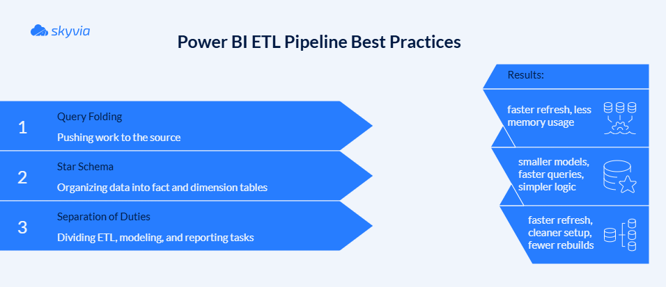

Best Practices for Power BI ETL Pipelines
Most Power BI pipelines don’t break because of missing features. When the incorrect work is done in the wrong location, they break. Whether the setup lasts or gradually devolves into maintenance depends on a few early decisions, such as where transformations execute, how you structure your data, and who owns what.
Skyvia infographic titled "Power BI ETL Pipeline Best Practices"
Utilizing Query Folding
One of those things you don’t notice until it stops functioning is query folding.
Power BI pushes transforms back to the source when it succeeds. Wherever the data resides, filters, joins, and aggregations operate. Refreshes are consistent, less memory is consumed, and less data is sent.
When it doesn’t, everything gets pulled into Power BI first and processed locally. That’s when refresh times start stretching.
The pattern is simple:
  • Apply filters and joins early.
  • Keep foldable steps (select, filter, group) near the top.
  • Leave non-foldable steps (custom logic, complex text operations) for later.
A quick check in View Native Query usually tells you what’s happening. If that option disappears, folding already broke somewhere upstream.
Building a Star Schema
Flat tables feel convenient until you try to use them.
A star schema separates what happened from the context around it. One fact table holds measurable events – revenue, quantity, transactions. Dimension tables hold everything else – dates, customers, products.
Instead of one wide table, you get a structure:
  • Fact table → metrics.
  • Dimension tables → descriptive attributes.
  • Relationships → how everything connects.
The result is smaller models, faster queries, and measures that don’t turn into puzzles. Power BI works better when it doesn’t have to guess how you organized your data
Separation of Duties
Most setups subtly go off course at that point.
Power BI makes transformation inside the report feel like the obvious choice, and obvious choices have a way of compounding. Before long, the .pbix file is doing extraction, transformation, modeling, and visuals – a one-file empire that nobody planned and everyone depends on. It works. Until it reaches 400MB, even the bravest won’t touch it.
Large files slow down. Refreshes get heavier. Logic becomes harder to track. And every report starts solving the same problem again.
A more stable pattern is to move heavy ETL upstream:
  • Dataflows or pipelines handle cleaning and shaping.
  • The model stays focused on relationships and measures.
  • Reports stay lightweight.
In practice, that also splits responsibilities. Data engineers define the pipeline. Analysts build on top of it. The result is less overlap, fewer surprises, and a setup that doesn’t need rebuilding every time something changes.
